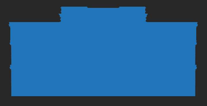

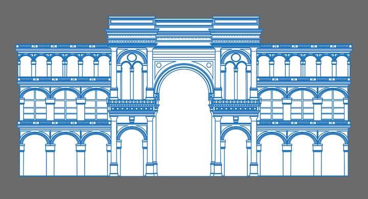

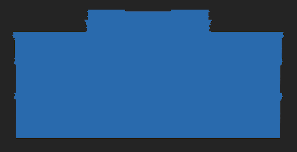

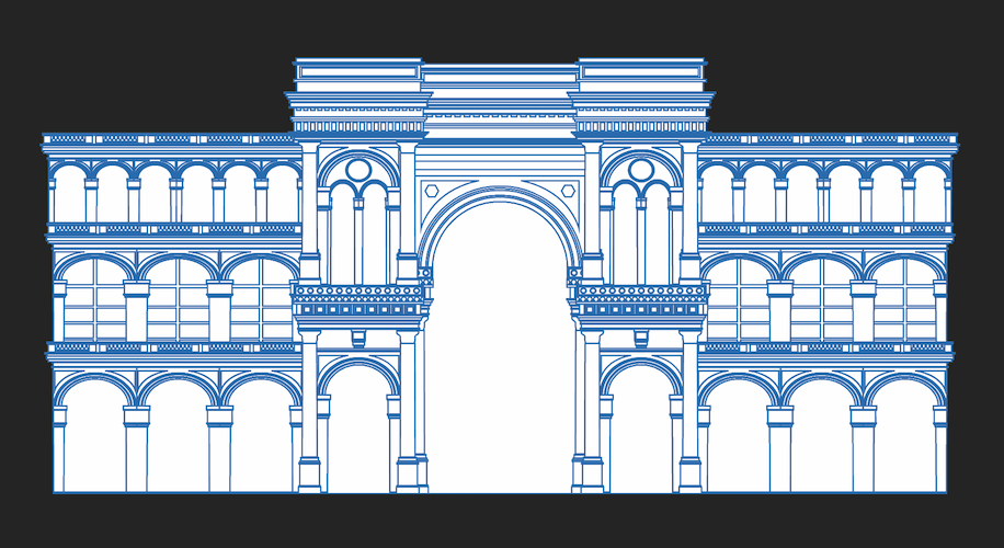

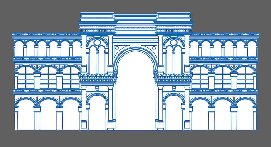

Ungrouping changing the appearance of artwork
@tudor Can you also attach the original Illustrator file?
Sorry if my assumption of it being an Illustrator file is wrong...
@William-Kansepa It's probably exported from a CAD app.
@tudor The drawing contains groups using shape combine operations. These can be selected after 3 or 4 ungrouping steps.
Use Styles -> Expand Group first and then ungroup all.How many Ungroup steps were used in Illustrator?
Ungrouping groups with shape combine operations will have similar results in other apps (where this feature is available).
One thing that I could do here is to stop Ungroup All at groups having combine operators. I added this to the backlog.
I also tried the PDF export and then import thing. And since exporting to PDF flattens the shape combine operations, the ungroup all worked as expected after importing.
