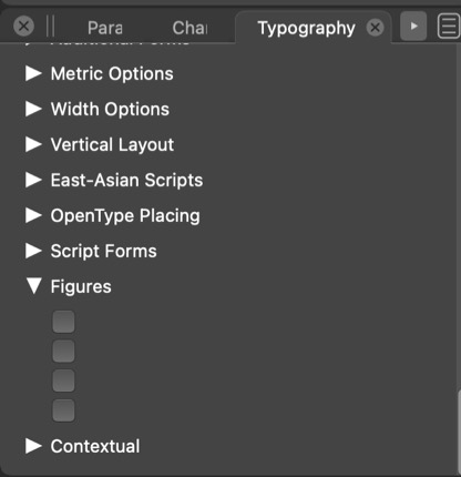

Typography Panel Bug?
Using a profont that has multiple figure versions available the panel does not show this. I cannot tell here if the pdf image is showing... I'll also try a jpg
@typeglyph Welcome to Vectorstyler!
If you click the Typography panel's menu button in the upper right corner and choose 'All Features', is the 'Figures' category still blank?
the image of the typography panel is showing the "all features" option. Many of these sub-items are blank. In this particular "Pro font" I know that the figures feature:
Tabular Lining
Proportional Lining
Old-style
Old-style TabularI also verified this with three other "Pro Fonts" that have multiple figure styles, all three were blank as shown in the jpg image.
These four fonts do show the figure styles in other non-adobe software programs.Professor Graphic Design
@typeglyph Can you please write which fonts don't work?
I tried here with Adobe Caslon, Garamond, Minion and with Myriad Pro, and the Typography panel shows all the options under Figures:
I have reinstalled and updated Vectorstyler: Arno and Minion are now showing all figure styles as well as Hypatia.
I think it was the reinstall and update that made this go away.

@typeglyph Great!
@typeglyph Great that it was sorted out.
It is not clear what could have caused this, if occurs again please let me know.
