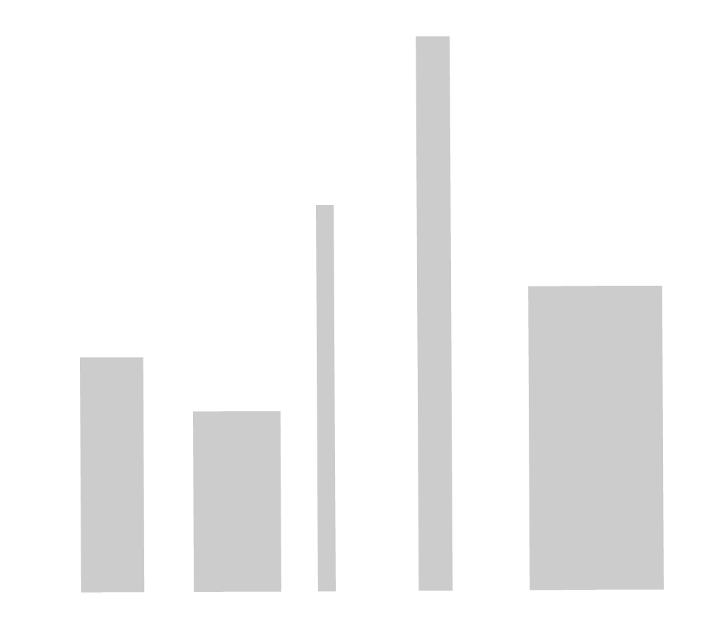

  • Let's say I have a bunch of different rectangles like so:
    Is there a way to set the same width on all of them at once?
  • Yes, you can do it from the Alignment panel > Align Size — the size of the last selected object is the one used for the others:

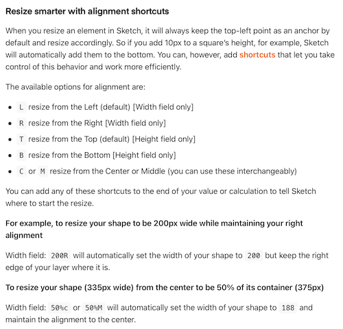

    Sketch does it like this:
  • Global Moderator
    @tudor those are interesting options, but they do not solve the problem being discussed here. Any of them (minus syntax) could easily be combined with any of the three options I suggested; there is no overlap
