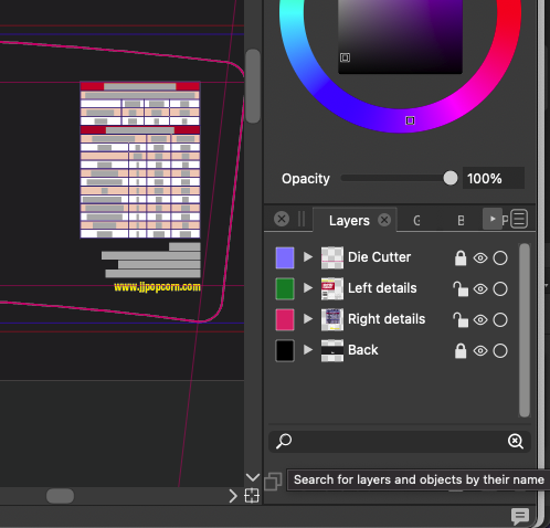

      Selecting groups and trying to nudge or move with the mouse has some odd results see vid: https://drive.google.com/file/d/1wPdMHXMCCkCKWkcJ_XnGLmh10j-Pa4vn/view?usp=sharing
      I've overcome the problem by moving the groups that I need to reposition, onto their own layers, which is probably the best workflow choice going forward when putting jobs together in VS.
