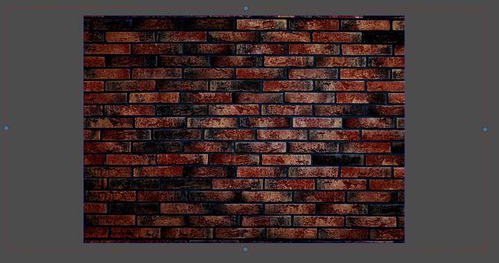

Can I set the blend mode for individual image effects? I am simply trying to make a bitmap background darker with brightness & contrast, levels or curves, but I need the blend mode of the image effect to be luminosity for the effect to look natural or just have the desired look.
When the desired look has been achived can I flatten the effect and bitmap into a plain bitmap layer. No need for VS to process image effects forever.

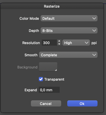

The Object -> Rasterize should do this.

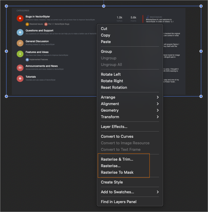

The Object -> Rasterize should do this.Suggestion inspired by Affinity - a trim option (trim to artboard) when rasterizing.
I just need the part that covers the artboard when I rasterize. Whatever is outside is not needed at that point. Makes total sense to erase it when rasterizing:
It could easily be an option here:
Excellent options btw - just need that one extra

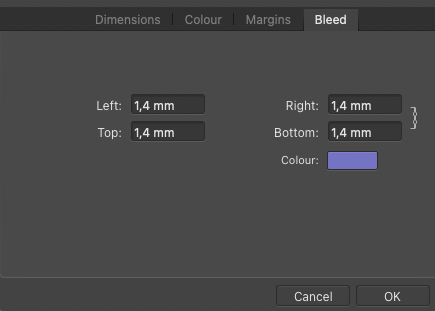

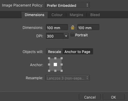

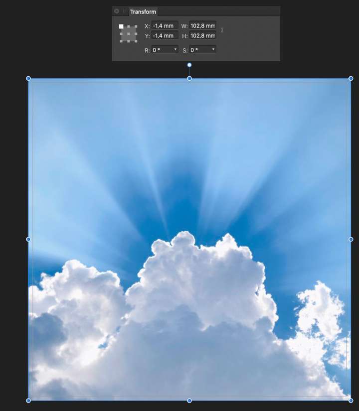

What happens in AD when the artboard has a 4 pt or mm bleed on all sides?
Is that taken into account — is the rasterized image 8 pt/mm bigger?
@b77 said in Blend mode for image effects + flatten/merge:
@Ingolf Interesting.
Is that taken into account — is the rasterized image 8 pt/mm bigger?Yep, indeed it is.
Example: 100 mm x 100 mm document with 1,4 mm bleed on all sides:

@Ingolf said in Blend mode for image effects + flatten/merge:
Creating a clipping shape with the artboard size for the image will work for now.
Added the trim option to the backlog.
