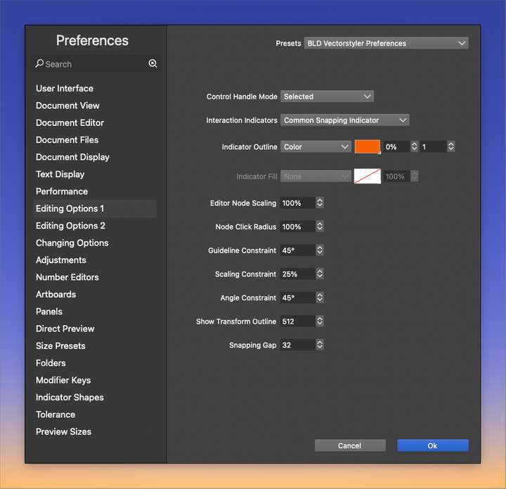

    This is my current preferences panel for editing options 1:
    Looks like I have angle constraint at 45 degrees. Is this not the default? What is typical?

  • @Boldline Yes, 45° is the default.
    Sorry then, I don't know what's going on. I thought you changed it to a smaller value (15° or 10°) which would make nodes "jump" along those angles.
