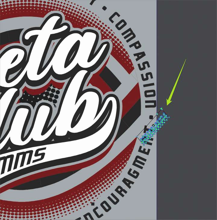

I wish it were harder to select objects that are clipped and hidden away from view. In this example, I often inadvertently select objects that are clipped and not in view when trying to click on something overtop - in this case letter shapes.
I don't know what the balance needs to be because I also want to be able to access and edit clipped items without too much difficulty. I think if we're using the secondary option for the transform tool, or if we use the layer system to select that sublayer within a clipped group, that would suffice.

@Boldline The node tool will select any path / shape inside a group (including clipped), for editing. I'm not sure yet if there is a safe way of not doing this (these shapes must also be selectable somehow).
I was thinking if the main selection - the transform tool itself would not but choosing one of the alternative transform options would - because it would be a deliberate thing to want to select objects hidden/clipped. - this does not take into account a solution for the node editing tool itself however

I think the main transform tool is not be able to select into clipped groups. If it does so, then it is a bug.

My fault - I was not thinking of it clearly - the transform tool does not select clipped/hidden individual items. So the transform tool is not relevant to this.
