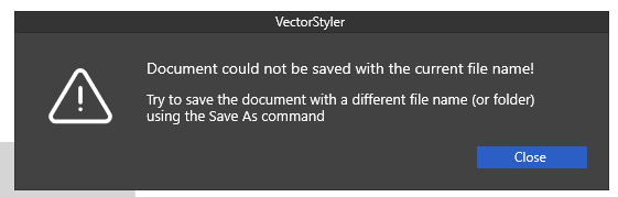

        if I close VS (1.1.065) with the "x" in the upper right corner
        and choose in the following dialog "Do not save".
        I still get the following message:
        Find this message a bit nonsensical the
        because did not want to save.
        If I first close the document and then close VS
        as mentioned above, this message does not appear.
          VectorStyler @Subpath
          @Subpath I tried to replicate this on Windows, but here the closing was fine.
          It could be again some resource mixup, try removing the workspace.xml and settings.xml files form the VectorStyler user data folder.
            Subpath @VectorStyler
            @VectorStyler said in update 1.1.065:
            Thanks, removing the workspace.xml and settings.xml files from the VectorStyler user data folder
            dit fix it.
              @Subpath Ok, but this means that some form of resource mixup does happen here. Next time, if this occurs, send me both the settings.xml and workspace.xml files.
                i just renamed the files and put them in another folder.
                will send them to you
