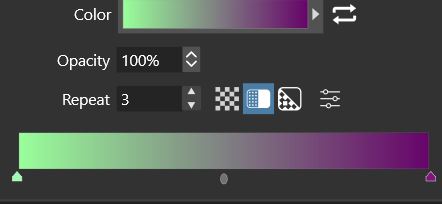

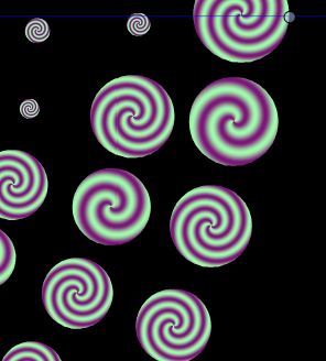

      Also, I'm just playing with the transform tool & gradients, and I notice that the number of (gradient) repeats is not accurately implemented in the objects for specific values:
      • repeat = 3

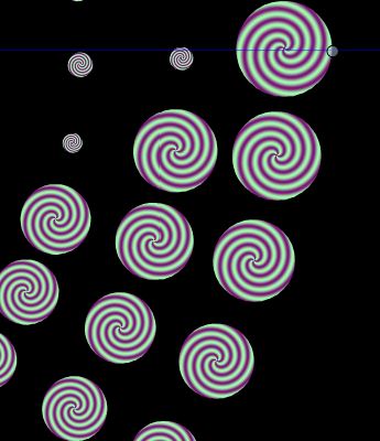

      -repeat 4, correct:

        As for the repeats: this is not shown in the Gradient panel for the gradient color editor (knobs must align positions), and when editing on the canvas. But it should be shown in the "Color" drop down and the object. So if there is an example for this, send also that.
