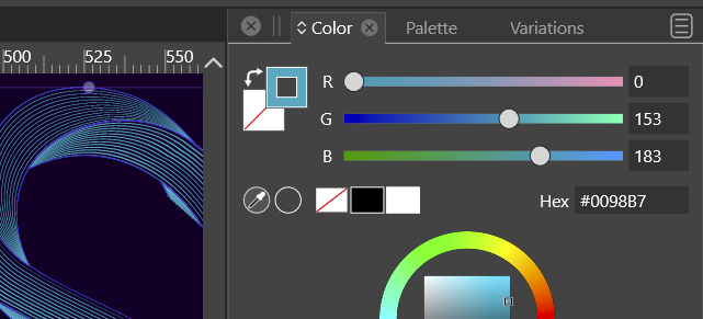

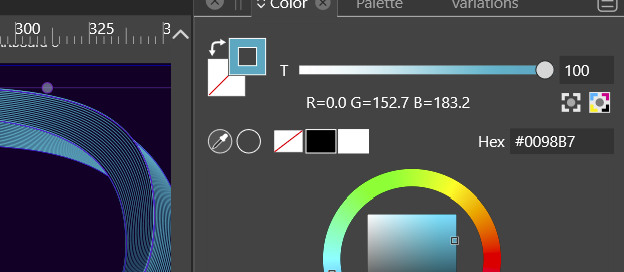

So far I've tested VS with 'RGB sliders' colour panel. For this object, I've got this colour tint correction:
When I change to RGBsliders, it is fine but as soon as I deselected the object & select it again I always get the tint correction. I don't know what I could have done to explain that.
@Pat If the selected color is a global/spot color then the Tint is shown, there is no way around this for now.

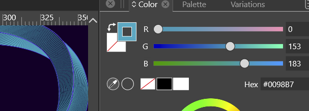

@VectorStyler ... and after closing & reopening VS, the colour panel of the 1st object is fine:
