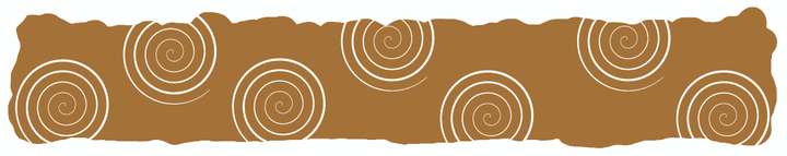

      Scenario:
      I create a Clipping Group using a normal flat colour: 0_1669110141231_Clipping Group A.png
      It's possible to change the hue of the mask to any other: 0_1669110156358_Clipping Group B.png

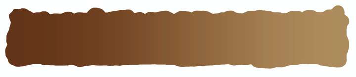

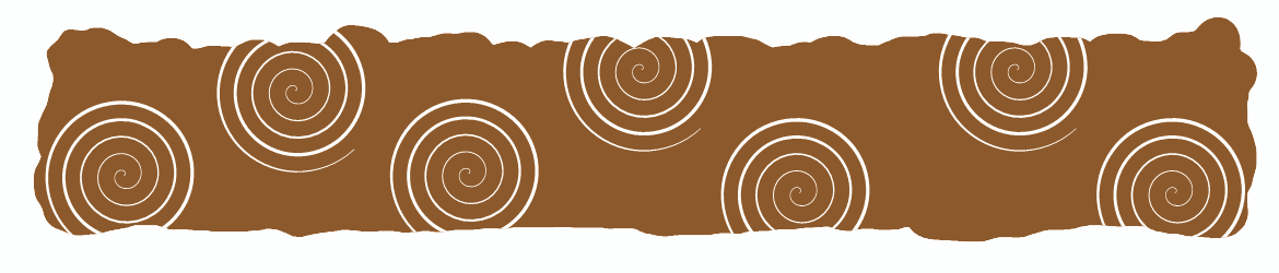

      BUT any attempts to change to a gradient fill will affect the whole Clipping Group:0_1669110176674_Clipping Group C.png
      Also note that if you initially start off with the masking object that has a gradient fill, you won't see the above challenge...
      BTW this is on Windows 10 with latest updates.
        VectorStyler @William Kansepa
        @William-Kansepa Yes, this seems to be a regression.
        Somehow the gradient ends up on the top of the group.
        In the Appearance panel, drag the "Fill" under the "Group" to fix this.
