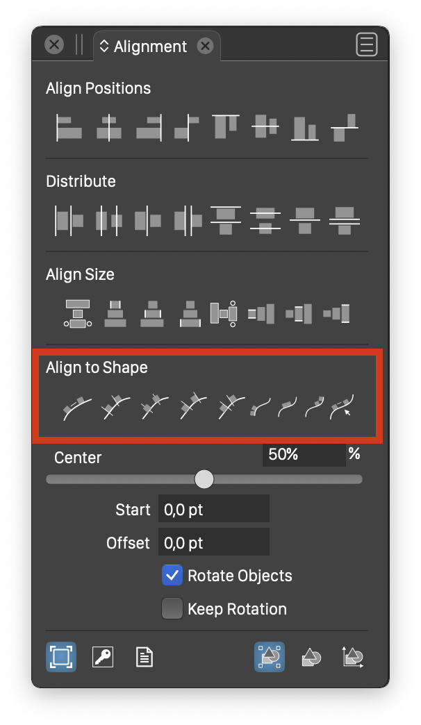

    @Igull said in Distribute/Align Shapes Help:
    use the 5th button along the top row to distribute
    This does not distribute along the length of the path.
    The alignment along path options are in the 4th row.

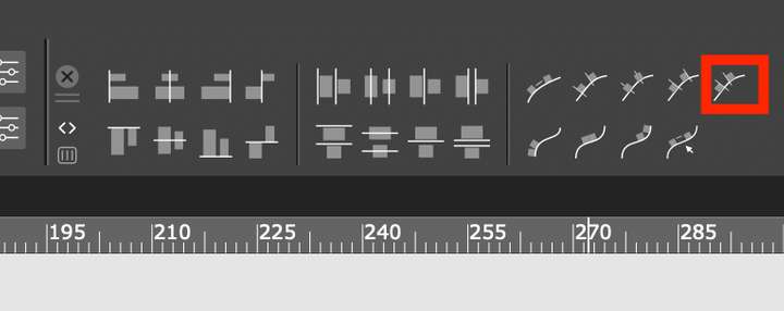

  • @VectorStyler
    Yes, that's the correct button, 5th one along in your red rectangle, I don't have mine set like that - sorry about the confusion 🙂
