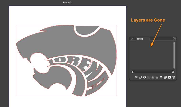

        Not sure if this ties in with the missing sections of path and nodes, but now I have no layers available in that file. I used to have three layers - one with the image locked, another with the nodes and work I was doing, and the third was just empty and unused. I'll send this updated file to you as well with a new name of "lost layers"
