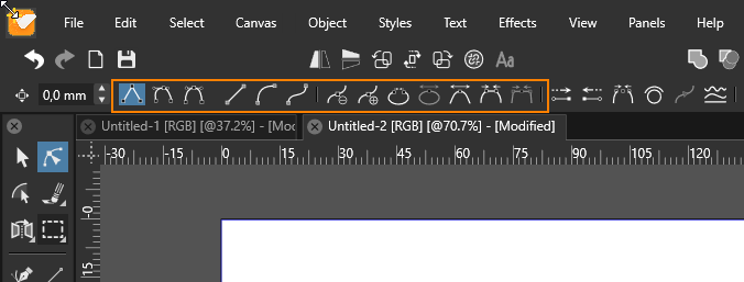

                                    Merge nodes at center, button in Path panel and Context panel.
                                    I wanted to test this feature and accidentally discovered that hover over these icons has the same result as clicking: 0_1669672443475_screenshot_20221128_225311.png
                                    b77B VectorStylerV 2 Replies Last reply Reply Quote 1

                                        b77 @encart
                                        @encart said in update 1.1.067:
                                        I wanted to test this feature and accidentaly discovered that hover over these icons has the same result as clicking.
                                        Replicated here. You need to disable 'Preview Shape Combine' in Prefs > Document Editor for now to avoid this.
