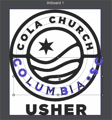

I'm running into a consistent problem when I am setting type on a path when a shape effect inadvertently gets added to my text in the process of sizing the font and arranging it into position on the path. When I go to expand the live text into a shape, it throws the entire wording off track and out of position - like in this attached video.

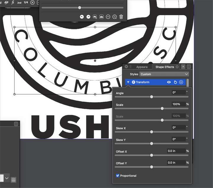

I remembered from an old conversation on this topic that I needed to go look in the shape effects panel and in doing so, I saw a "transform" shape effect added to that live text. When I opened the "transform" option, none of the settings seemed altered from normal settings... and when I did adjust them, it altered the selection box around the text, not the text itself. I was able to delete this shape effect from the shape effect panel and then expanded the text without issue at all - but where I am confused is why it was added to begin with, what I might have done to do so and what purpose it serves? I may have scaled up or down the font size. I do know I copied the first circle path used for the top wording and then added new text on a path to that for the bottom words. I did scale the circle path so when I flipped the wording inside, it was following the same overall path of the upper circle again.
Perhaps there is a better way to create text on a circular path both above and below and have it all face the right direction?

@encart Thanks for your good idea. I did try exporting it to a different file and the issue carried over. I think it had to do with scaling the copy of the initial circle path, because it did not negatively affect the first circle and text - just the second one I had modified.
I was able to solve it for today's project - more thinking long term now -

The "Transform" is added to the text if it is scaled.But when converting to curves, it should keep the positions.
