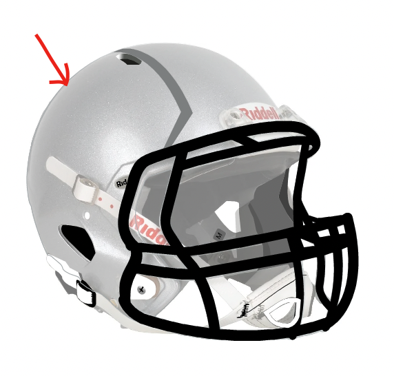

      The screenshot below shows where the stroke is located in the design. I also attached the file itself to this post.

        @Boldline Tried to replicate this, but here it seems to be working.
        I think in this case it is important to know what panels are open (not visible from the recording).
        This could be an environment issue (settings / workspace).
          @VectorStyler Similar issues were happening in another newly created file. I tried resetting the workspace and that did not fix the issue. Removing the customized preferences file did solve the issue. Unfortunately, I did not save the old pref file to send in. I apologize. If anything happens again I will send it in
