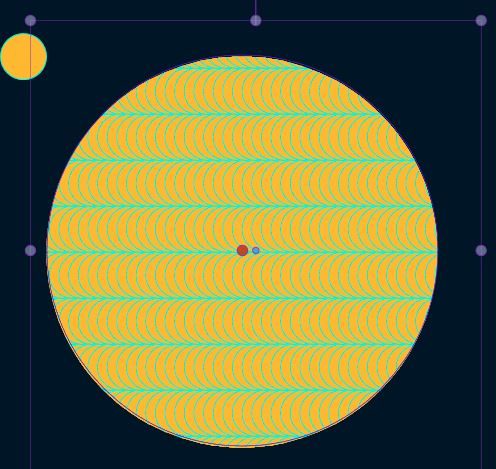

  • I'm testing the repeater feature but I don't get it. I've read some forum topics and the doc but the issue I encounter are not there.

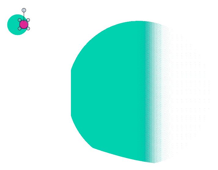

    First, I define an object as symbol, easy:
    Then, I pick this symbol from the repaeter panel, easy:

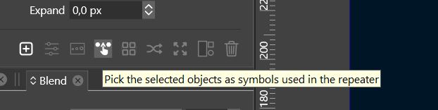

    Then, I select the object used for repeating and I press the 'plus' sign, easy:

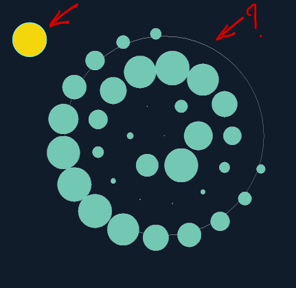

    and I get this:
    it's not what I want, so I change the gormetry, fine:

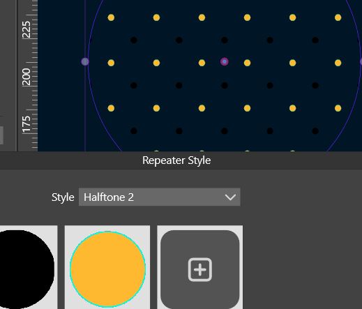

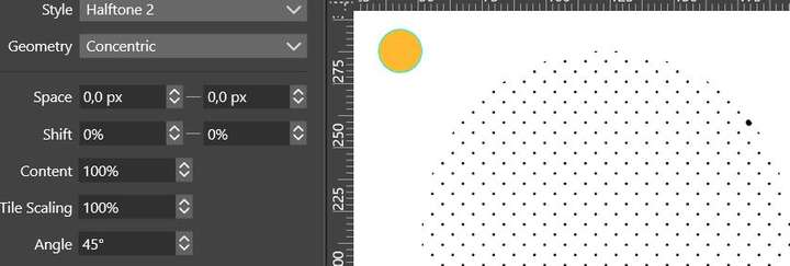

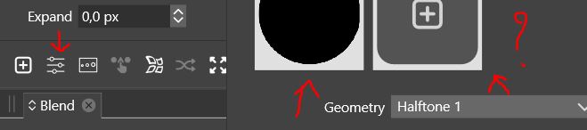

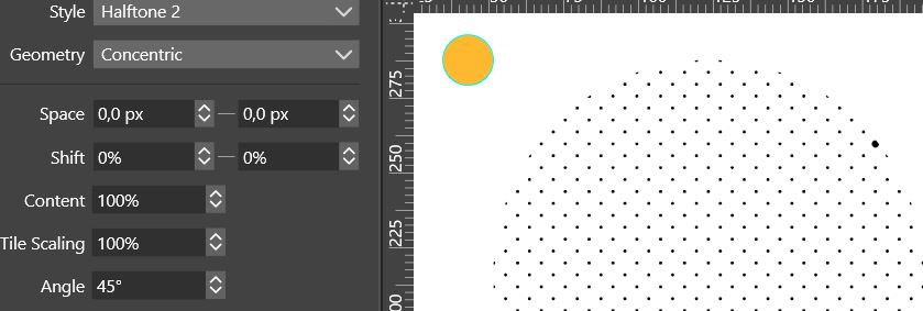

    but I want smaller objects at the periphery, therefore I do change the style & I get... black dots:
    Ok, I press on "edit" & don't see my symbol. :
    I add my symbol & delete the black one (many steps already)0_1676281645145_Result5.JPG Ok but not yet what I want.
    every time I change the style, I get black dots and I have again to repeat all the steps but I never succeed to get what I want.
    Thanks for any tips ☺

    It is difficult for me to know what result you are aiming for.
    i guess a video with your steps would be maybe a little more helpful
    ( or a sketch of the end result )
    My guess is that you want to have smaller objects
    on the outer edge of the circle
    Here is a video the way I did it with a simple
    object in the repeater.

    It will help me but I still wonder why when we change the style in the 'Repeater' panel the symbol used is not the one we defined at the beginning as a symbol? It remains non intuitive for me...

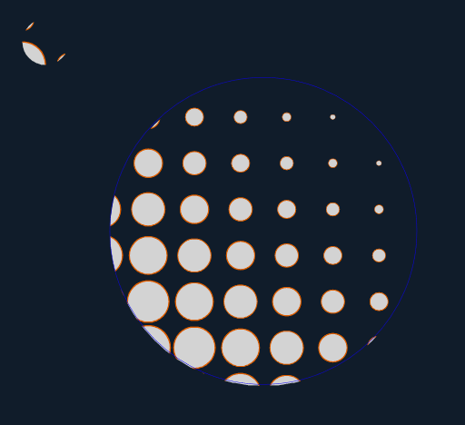

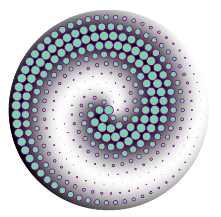

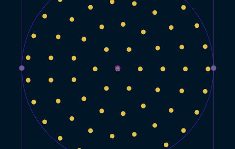

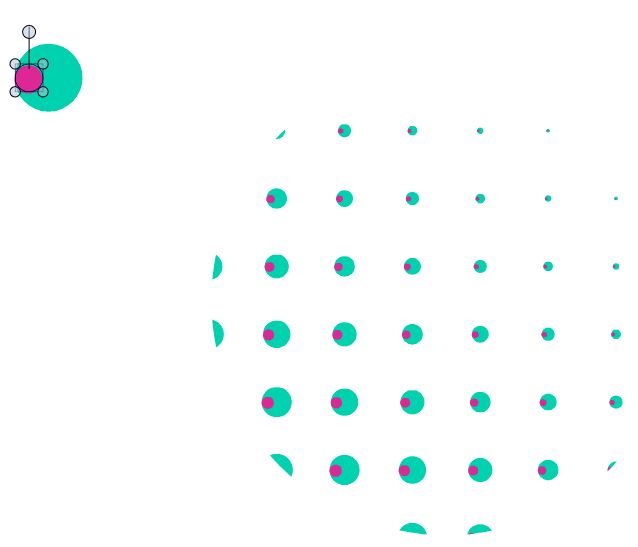

    @Pat I think one of the issues here is that there is no scaling intensity set.
    In the attached example, a repeater is created from a smaller object filling a larger one.
    • this can be simply done by selecting both the smaller and the larger objects and creating the repeater from the panel.
    The smaller objects fills the larger (and it is clipped). The larger object has a circular gradient (see it in the Appearance panel), that can also be edited with the interactive gradient tool.
    Now the trick is: in the Repeater panel, in the "Scaling" field the "Object Content" mode is selected. This means that the repeated object is scaled according to the intensities in the object content (that is the gradient in this example).
    Obviously, this extends to other objects (or groups), including images, where the image content can be used to scale the repeated object.
    Recording: https://recordit.co/1C1RFNyn86

  • @VectorStyler said in Repeater : what do I do wrong ?:
    • this can be simply done by selecting both the smaller and the larger objects and creating the repeater from the panel. The smaller objects fills the larger (and it is clipped).
    Thanks ☺ Yes, I get this but I thought it was better to make it a symbol... & I would prefer that the small object is not clipped to be able to modify it. Is this possible?
    Ok, I didn't think about the appearance panel. I will.
    Ok, I get this too. But why can't I change the style without loosing my small object & getting just simple black dots.

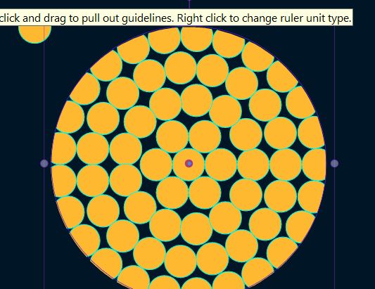

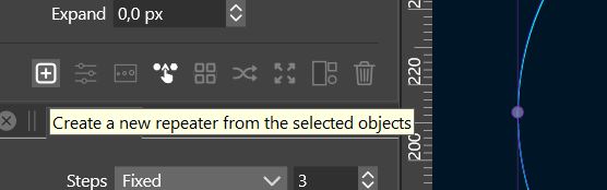

  • @VectorStyler ... and when I select both object and create a repeater through the panel hamburger (top right), I get this:

    @Pat said in Repeater : what do I do wrong ?:
    Symbol will also work for this.
    Yes, in the Repeater panel menu uncheck "Clipped Content"
    This does not happen if the symbol is used. In the example I did not use a symbol, but with symbol it will work the same.
    and the 'preview' option in the intensity window (Scaling --> Gradient) doesn't preview
    I added this to the backlog.
  • @VectorStyler
    When the style is changed, the symbol is changed (black dots) even if my object has been defined first as a symbol. I simply don't get it. The object we defined ourselves as a symbol should remain in the design whether or not the style is changed IMHO... but fine, I'll get used to this.

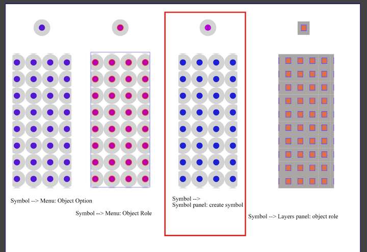

  • @VectorStyler I've defined the object as a symbol but changing its colour, adding a stroke are not repeated on the large object.

    As for the symbol case: not sure how the above example was created, but I attached an example with a symbol where changing the symbol style updates the style in the repeater also (of course, no colorizer is used here).
    Not sure if this was documented well, but if we want to use a symbol in a repeater, then that symbol must be drag&droped onto the Repeater panel from the Symbols panel (and most not be selected on the canvas).

  • @VectorStyler I've expended the repeater and got this:
    @Pat Yes, this is because it has a fill (that was hidden).
    I will try to find a way to deal with these.

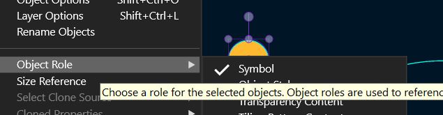

  • @VectorStyler To define an object as symbol, I did through the Symbol panel menu (Create Symbol) but when I go to the menu (Object-> Object role), it is not marked as symbol.
