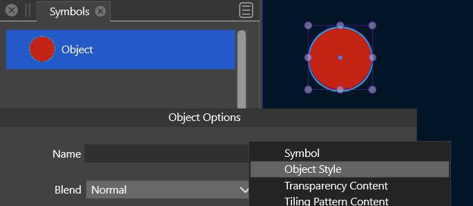

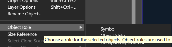

 @Pat The Symbols panel menu should also work the same. For the object role: did the object show up in the Symbol panel after the role was set?
 @VectorStyler said in Repeater : what do I do wrong ?: @Pat The Symbols panel menu should also work the same. For the object role: did the object show up in the Symbol panel after the role was set? Yes but :  and
 @Pat I think the Object Style role is not useful in this case (if the highlight means that it was used).
 @VectorStyler said in Repeater : what do I do wrong ?: @Pat I think the Object Style role is not useful in this case (if the highlight means that it was used). No, it is highlighted just because my mouse pointer was above it

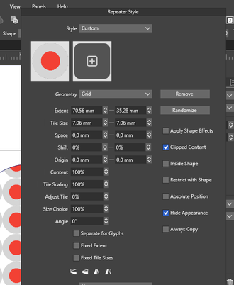

 @VectorStyler the repeater feature seems to me totally broken on Windows. I can’t get any consistent results : I change the color the size changes, I do ctrl-z and I get a shape I deleted earlier not used in a repeater object, no way to succeed to change any options of the shape through symbols. I get the same unrational results both on w10 & w11.

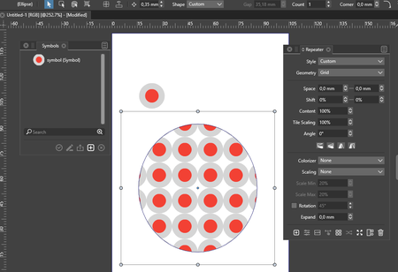

 drag and drop is workingi followed the Video from @VectorStyler could even change the shapes and color of the symbol

 @VectorStyler I uninstall and install VS. The drag&drop is not yet functional but now I can change the small object and the changes are repeated in the 'repeater' large object. It is already something nice  I might have to delete the x & y.xml (forgot which ones) to start freshly because I've noticed that I kept my UI. I might have to delete the x & y.xml (forgot which ones) to start freshly because I've noticed that I kept my UI.
