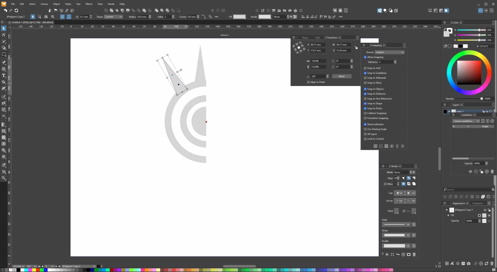

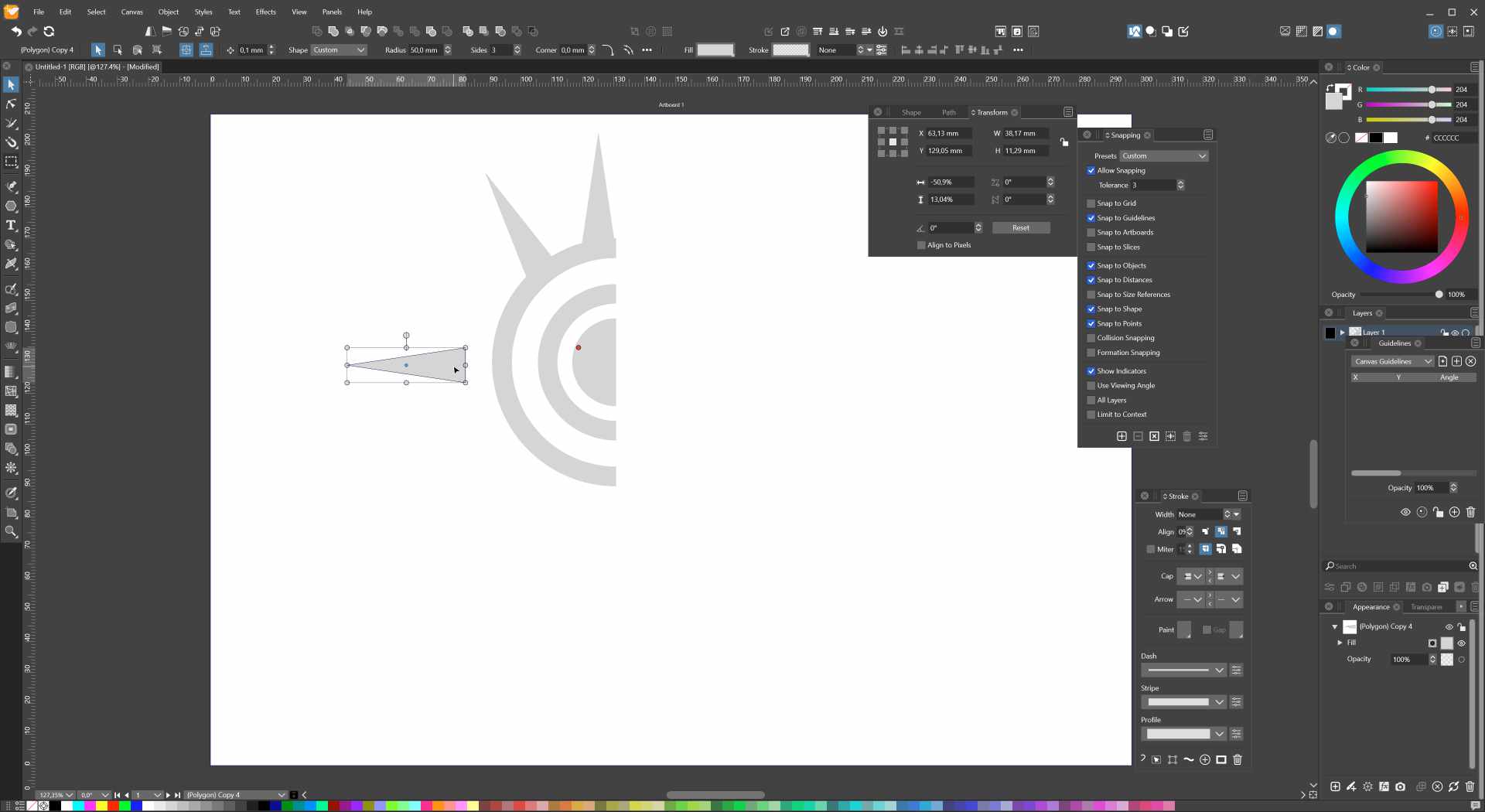

      I have this object I wanted to duplicate and rotate around a moved center point:
      I select the triangle, ctrl+d to duplicate, and then I rotate the triangle by 30 degrees:
      Then I use ctrl+shit+r to repeat, and that 'sometimes' works. Then I repeat again, and the triangle ends up somewhere else:
      If I use repeat again. the triangle rotates by 30 degrees, but it's position changes as well.
      I thought that if I duplicate and rotate after the initial operation, the object would duplicate and rotate around the center point.
      What is supposed to happen in the scenario? (surely not the jumping around the artboard?)
      This also happens when I duplicate a previous duplicated and rotated object as well. But when I deselect, and then select it again, the duplicated object ends up on top (as expected, I have duplicate offset set to 0,0). Manually rotating while holding shift gives the expected result.
      WIndows 11

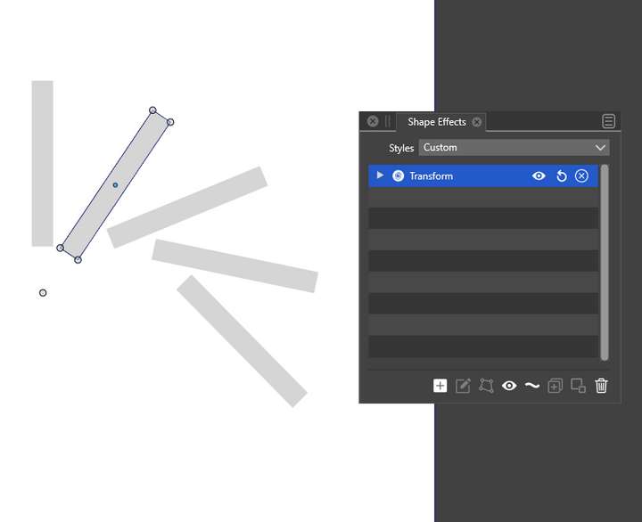

        Subpath @Gremriel
        @Gremriel
        could be happen while VS keep the transformation steps
        if there was some Object movement before the rotation
        this could influcence the rotation steps
        you can watch this in the "Shape Effects" Panel
        Panels > Effects > Shape Effects
        looks like this:
        Select your Object and watch that Panel
        i use convert Object to curve to get rid of them
        btw for this kind of rotation you can also
        use transform rotate
        Object > Transform > Rotate
        see video here

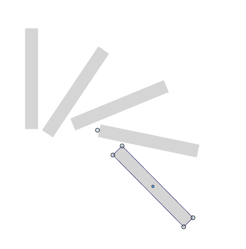

            @VectorStyler Hi - I hope all is well! I just ran into this one too, as I did not understand the behaviour. What I did:
            • Create rectangle
            • Shift-R, move pivot point
            • Deselect
            • Reselect
            • Manual rotate with duplicate using ALT
            • Ctrl-D * 3
            I changed all my preferences to not move during duplication, but the outcome was as above and unexpected.
            Windows 10
            VS 1.1.079
            Windows 10 Pro | 22H2

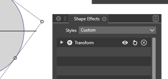

              @syllie
              seems to be another transformation
              in your process of rotation
              To check this, open the "Shape Effects Panel"
              "Panels > Effects > Shape Effects."
              Where you can see if your shape already
              has a transformation effect
              Create a shape and rotate it to see whats happen then.
              If this is the case, convert your shape into a curve
              before you start to rotating it
              (move the pivot point ect.)
              do this also if your object is already converted into curves.
              Because this will delete all unwanted transformations
              and then set your pivot point and create your rotation
              In general I would recommend to use the Transform Panel
              "Object > Transform > Transform" for such actions
              in my post above is a video how to use
              the transform rotation panel

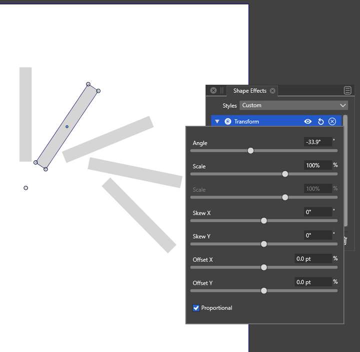

              i tried a bit the way you descriped
              @VectorStyler this looks like a Duplicate transformation bug to me
              the Transform Panel works as expected

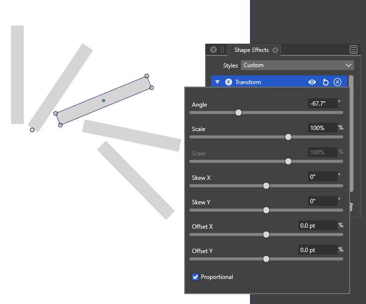

                There is only one transformation applied, the rotate.
                I do understand how to work around this. But I believe the behaviour is not correct.
                Actually, it is a bit more curious, as if I inspect the 3 item (which was made with CTRL+D), it seems to think that it had ONLY rotation applied, where there is obviously an offset too.
                  VectorStyler @syllie
                  @syllie said in Weird behavior when repeating duplicate with a rotated object.:
                  I agree, this looks like a bug, added it to the backlog.
