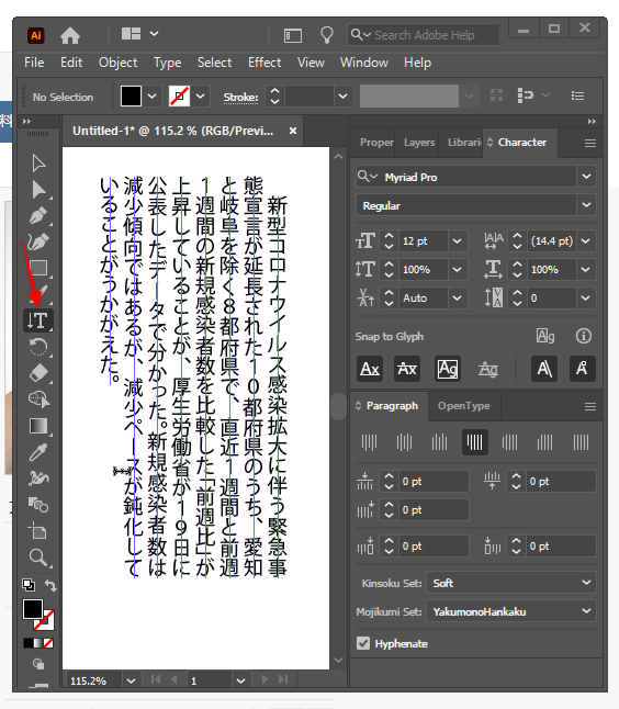

              This is vertical writing in Illustrator.
              Characters flow top to bottom and lines flow right to left.
              Common format in Japan.
              Even Corel is hardly support Asian typography, so I don't think it's possible to implement vertical writing mode so quickly.
              Way more complex than RTL.
              You also should support line breaking rules (Kinsoku), letter & word spacing rules (Mojikumi), horizontal word in vertical writing (Warichu), phonetics (Ruby) and so on.
              Only vector graphics app fully support vertical writing in the world is Illustrator.
              (Also InDesign and Quark but these are not quite vector graphics app)
              Here's the Asian typography feature guide for Illustrator.
              https://helpx.adobe.com/in/illustrator/user-guide.html/in/illustrator/using/formatting-asian-characters.ug.html

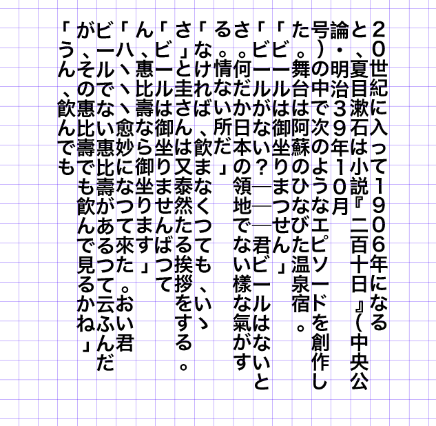

                I'm not a programmer, so I'll show you just one example of the results.
                For the sake of clarity, this is a solid typesetting that is impossible in reality.
                Vector Styler example
                QuarkXpress example
                —Since it is not difficult to input Japanese conversion with VectorStyler, I copied and pasted it.
                —"Yakumono" remains a horizontal type.
                —"Justify" is invalid, and forced line breaks make it look like a lag group.
                —Only specific Japanese fonts can be recognized.
                Of course, many other rules are needed.
                However, for captions, names, and small sentences, the performance of "Canvas X Draw" will suffice.
                My private evaluation that implements vertical typography.
                5 InDesign (for work)
                4 QuarkXpress (for work)
                3.5 Illustrator (for work)
                2 Canvas X Draw (for hobbies)
                1 Swift Publisher (for hobbies)
                0.5 CorelDraw (for hobbies)
                0 Affinity product (for hobbies)
