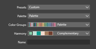

I have created a custom palette, which has 7 named colour groups. The palette loads fine from its saved version, and I also have it as a preset palette.

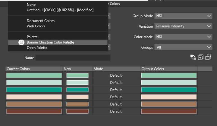

When I use an effect like Effects > Replace Colors > Replace Colors I can see the palette for selection:
However, picking it from the dropdown does not 'set it' and the colour groups show 'the full palette'.
I think I simply do not understand how this is supposed to work - but what I am after is colour substitution within the 'same colour group' of the custom palette. Any hints and tips?

@syllie Replicated here also, could be a bug in the Replace Color.
Will be fixed ASAP. -

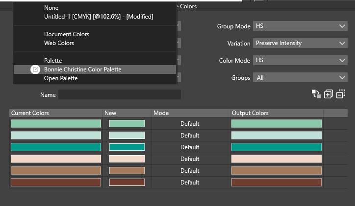

It is still in the backlog.
Palettes can be renamed now, but the replace color view is a bit too complex and requires some redesign.
It is working now as expected, except the selected palette colors do not show up in the Output Colors column, but they are used only after confirming the change.
Also the Palette and Color Group fields are still not updated correctly. -

@syllie Not dropped, just requires a bit more thinking
But it is working now, as expected except the preview in the Output column.
