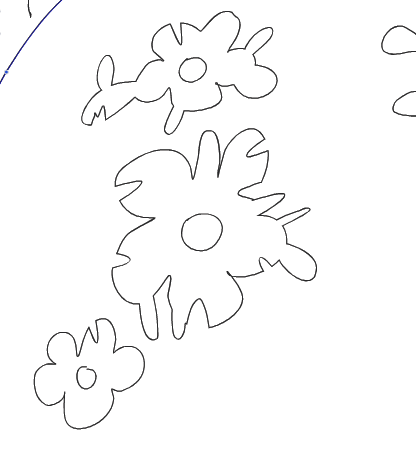

      https://recordit.co/sxJhwELI3Y
      I am certain I tested this before with intermittent success. The option 'Exclude Closed' is off.
      • I am able to add and extract new shapes with intersecting paths (starting inside or outside the closed shape).
      • I am not able to extract a closed shape from an existing closed shape (as per manual "If a newly created closed shape intersects with an existing closed shape, it will be extracted from the existing shape." ) https://www.vectorstyler.com/documentation/shapes/pathsketch/#sketching-closed-shapes
      • A new shape is created on top of the existing closed shape

        @syllie Make sure you overlap the end segment over the start
        segment when you draw those circles at the end of the video.
        If I do that, holes are "punched" into the object.
        (With 'Exclude Closed' disabled, drawing closed shapes won't
        create holes).
