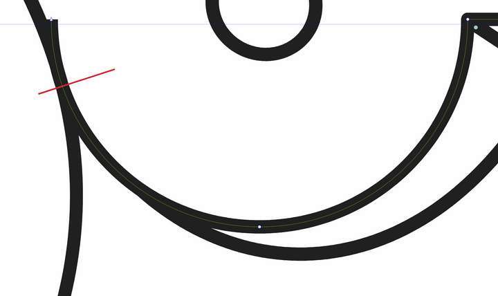

      Sometimes Vectorstyler drives me crazy because simple things are solved quite awkwardly. Even Belight's Amadine has a sharp cutting tool for paths. I'm always on the verge of buying CreativSuite again. Thanks for the help.
      VectorStylerV BoldlineB 2 Replies Last reply Reply Quote 0
        VectorStyler @Buntstift
        @Buntstift This seems to be a bug. Fix will be in the next build.

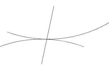

            maybe "Trim" could be a workaround in some cases
            Here a Video

                another workaround may, to use the "Eraser Tool"
                and choose a tiny Brush size
                Here also a video

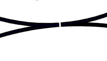

                  @Buntstift New build with knife tool improvements is available for download.

                    A suggestion I have for the Knife tool is making it
                    cut AND split the path in two separate objects.
                    Not by default, but maybe with Shift?
                    IgullI VectorStylerV 2 Replies Last reply Reply Quote 1
                    • IgullI Offline
                      Igull @b77
                      @b77 said in How I can cut a selected Path into two piece:
                      Noot by default, but maybe with Shift?
                      Not ANOTHER modifier LOL 🙂 🙂 🙂
                      Neil
                        VectorStyler @b77
                        A suggestion I have for the Knife tool is making it cut AND split the path in two separate objects.
                        This exists, but there seems to be a regression with the new intersection mode and separate does not work when the margins / nodes are overlapping.
