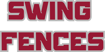

      I'm running into an issue using union to merge together the result of an offset path. Here is the video
      Here is the file I was working with:
      0_1683722519114_union operation issue.vstyler
      I tried cleaning stray segments and also selected all the shapes and making sure they were joined - no open paths.

        @Boldline Replicated here also, I will try to fix this ASAP.
        • S Online
          Subpath @Boldline
          @Boldline
          i did a "Break Apart" on the Outline first
          and did the "Union" only on each line
          (not both together)
          then the Result was ok
            Boldline @Subpath
            @Subpath Thanks for checking the file out and doing some testing. I love that we all try to find solutions. To get around the problem I was able to offset path them separately and using break apart as you did. Got it solved in the short term!
