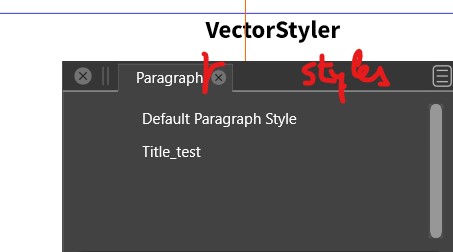

    1. Just a detail but it would be nice to add 'styles' to the name of the paragraph style panel:

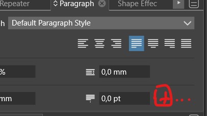

    1. It would be useful to add the possibility to create a paragraph style from the paragraph panel:
    as for character styles from the Character panel:

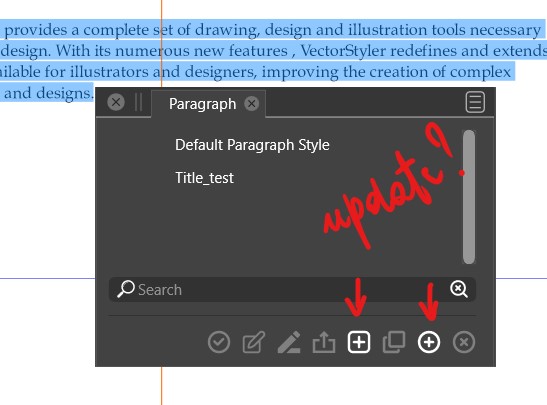

    1. It would be very nice to be able to update an existing paragraph style directly from the Paragraph styles panel.
    Thanks ☺
    @Pat said in Paragraph styles panel:
    Does this mean to "edit" or to "apply" to the selection?
    These should be possible now.
  • @VectorStyler I meant to edit an existing paragraph style after having applied a modification (to text, spacing, formating etc.). I don't see this possibility:
    @Pat This panel can only edit the style "definition". Highlight a style and then click on the second button at the bottom row.
    Please remember, that these styles are "linked" and editing the style will update all its uses.
    Otherwise, you have to use the Text -> Paragraph Style menu to edit local attribute overrides.

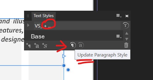

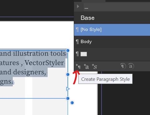

    In APub:
    1. Create a paragraph style:
    1. Update a preexisting style after any modification:

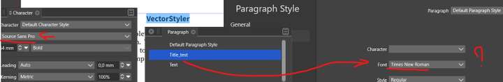

  • @VectorStyler I'm just testing the paragraph styles. I did a style for the title. The font used is Source Sans Pro. When I check the style in the Paragraph (styles) panel, it says 'Times New Roman'. These data should be identical:
    @Pat Send me the file where this occurs.
  • @VectorStyler Done, thanks ☺
    The issue is still in v. 1.1.088.
    About the font name: when editing the paragraph style, it will edit the style definition, and not what the text is formatted with.
    In this case there is an extra character override, with a font type and size on the selected text.
  • @VectorStyler I did not create any character style or override anything: I've just selected a font. It is not like this in layout apps. In InDesign (or APublisher), once a font is selected & a style defined, the correct font appears well in the "paragraph style edit":
