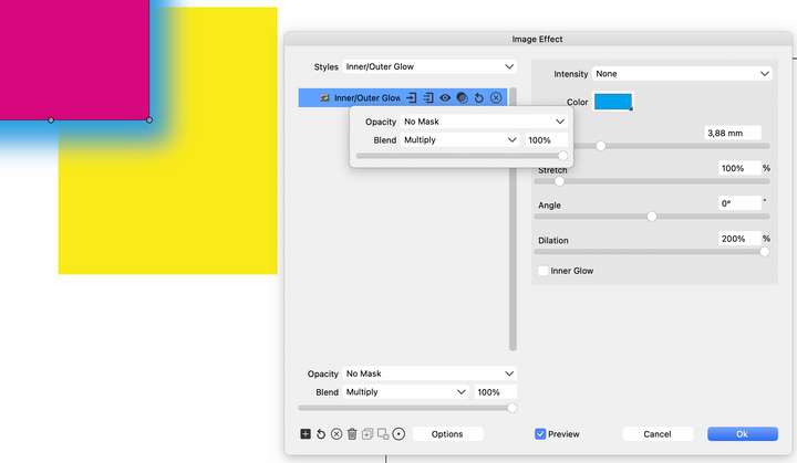

      1. When applying Blend Multiply to Outer Glow image effect. Outer Glow does not multiply.
      2. Why are there two times Opacity & Blend settings that effects selected image effect?
      Image example:
      magenta rectangle with a cyan outer glow should give a green result on yellow background. Now keeps cyan.

            @Ayo Finally, got to inspect this bug more, and it turn out it is not a bug 🙂
            The blend mode and opacity in the image effect settings controls how the resulting image is combined with the original image (not the backdrop).
            To combine with the backdrop, use the settings in the Transparency panel.

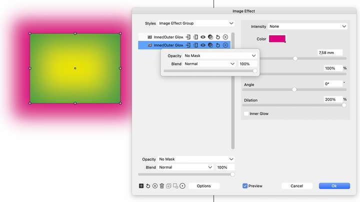

              Second problem while testing a multiple effect I run into the following error.
              Situation
              • effect 1; cyan inner glow over yellow shape/Blend multiply
              • effect 2; magenta outer glow yellow shape/Blend normal

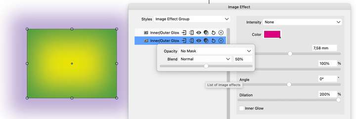

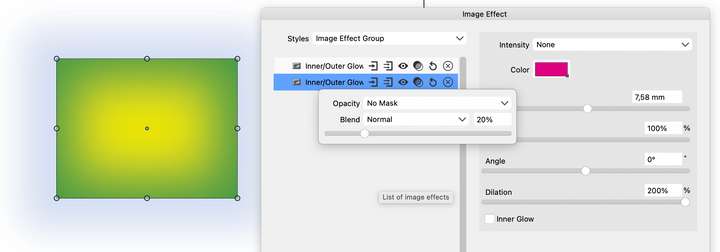

              Changing the opacity in the outerglow effect from 100 to 50 to 20% changes the color from magenta to purple bluish. Should remain a shade of magenta. Seems like effects influence each other
                VectorStyler @Ayo
                @Ayo said in Image effect Outer Glow Blend Multiply:
                Groupsetting changes/overrides Blend mode setting previously set for specific effect
                These Blend modes are used to combine the original image with the filtered (not the backdrop), so for each stacked filter (and then the final result) the original and filtered images are different.
                One important thing to know, in VS it is not possible to have the outer glow part combined with the backdrop using some composition (for now).
                I will replicate this case with the two glow effects, but it is most likely the issue is the interpretation of how the opacity/blend is used.

                      @VectorStyler said in Image effect Outer Glow Blend Multiply:
                      Do you mean that the given image example above (magenta rectangle with a cyan outer glow should give a green result on yellow background. Now keeps cyan.) is correct?
                        VectorStyler @Ayo
                        @Ayo The image in the original post should be correct.
                        I did not yet inspect the second image (for which I asked the file) 🙂
