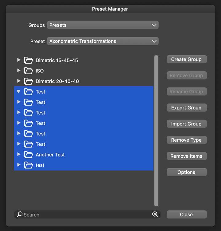

  • Ok, so I found all of my "Test" folders I was creating in the Actions panel under the "Preset Manager". I don't understand why are they showing up here and not in the Action panel where I created them originally.
    All of them are under the "Axonometric Transformations" title, yet only the ISO, Dimetric, and Trimetric showing up in the actions panel. All the "Test" ones are not.

  • So to add to this story...
    ...I have deleted all of the "Axonometric Transformations" actions from Styles > Preset Manager. However, the preset type (or whatever is the correct terminology) cannot be deleted. In other words, the action folder names "Axonometric Transformations" cannot be deleted from the Preset Manager.
    Also, when I open the Actions panel (Panels > Presets > Action) and create a new action folder, it does show up in the Preset Manager under "Axonometric Transformations > Folder". However, this folder is not showing up in the Axonometric Transformation action panel itself.
    Sorry, I know it's confusing, lemme try to illustrate all this with the usual video.
    https://www.youtube.com/watch?v=ShjejcTa_pw
    VS 1.1.094
    @pentool I will try to replicate this. It might be a bug in how custom actions files are handled.
