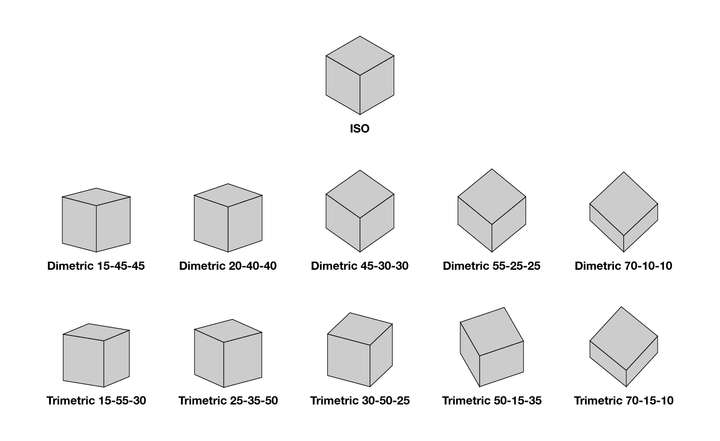

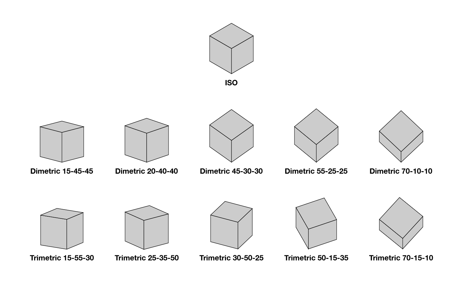

I've created a couple of axonometric transform actions that can help creating designs in 3D. You prolly know about isometric, which is the most basic. And there are various dimetric and trimetric projections as well.
So to get started...
- Download the actions from my dropbox thingy
- In VS, go to Panels > Presets > Actions
- In the Actions panel's menu, at the bottom, select "Open from file..." and load these actions.
- Create squares, ovals, triangles, whatever shapes, and select the actions for whatever axonometric projection you want to transform the shape to. For each transform, there's action for left, right, and top view.
So if you want, say, a Trimetric 30-50-25 transform, just open that up in the "Trimetric > Trimetric 30-50-25" actions folder, select the shape, and click the left/right/top action. Done.
