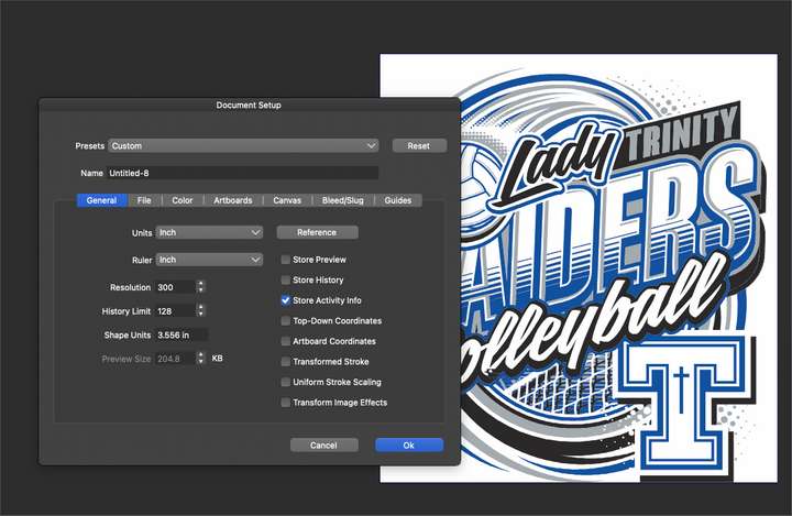

      I don't know if it's always been this way, but when I make a copy of a selection from a VS file and then use the "New from Clipboard" option, the relevant document settings do not transfer over along with the selection.
      Here is the original art along with the document settings:
      0_1691268507493_ed0edc6f-6bd6-4996-9e6a-0e893ce2a0d0-BLD 2023-08-05 at 16.47.56.png

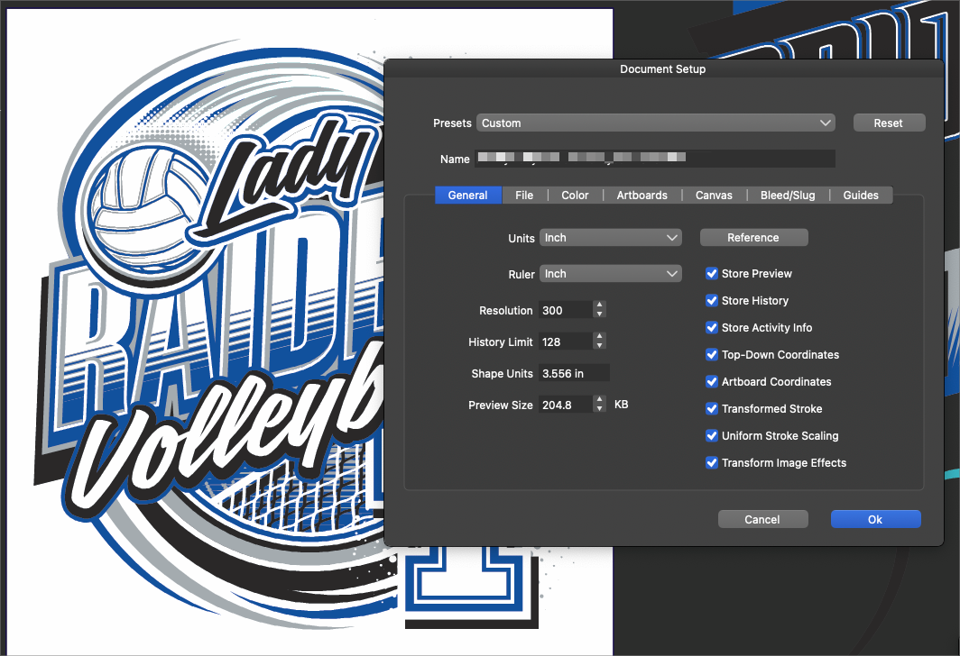

      Here is the "new from Clipboard" result:
      0_1691268431714_91581476-8c55-471c-b28d-91a31b3ce8a9-BLD 2023-08-05 at 16.45.22.png
