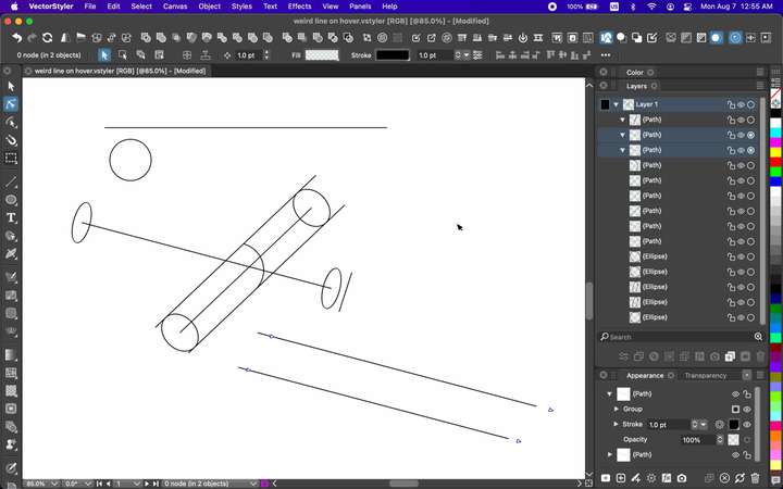

      Why am I getting these weird lines when I hover over single line segments?
      When I draw line segments then I switch to the Node Tool and hover over on some of them, a weird line shows up at a completely different location. Also there are blank anchor points are flashing up and "traveling" along as I move the cursor over the line.

        Notice when I break apart the composite object in the file, the 2 lines will have anchor points in the wrong place. They are no longer selectable with the Node Tool.
        Also notice in the Layers Panel that the 2 selected lines (paths) have a disclosure triangle next to them as if that was a container (group) of some sort with nothing in it.

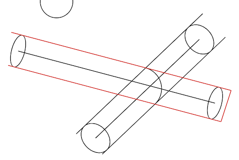

          @pentool The object in red is a composite of groups of lines, and some of them have no color
          for the stroke, and they are a bit offset from the black line (in the direction of the segment,
          since we talked about the topic in the other thread).
          I used Break Apart (Ctrl-K), Ungroup All and also Expand Appearance to get to them.
          It might still be something wrong with the way the invisible lines are displayed when in node editing
          mode, as the offset of the no-color line is nowhere near that big.

            @b77 I am not sure what you are looking at but all objects/lines (including the composite ones) have stroke color. They are black. Otherwise you would not be able to see them.
