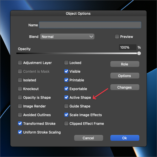

I was thinking the "active shape" option in the layer panel might accomplish this, but it does not seem to.I was also thinking the isolation mode would due the trick, but even in isolation mode, I can still edit the containing shape

@Boldline Active shape is something else.
