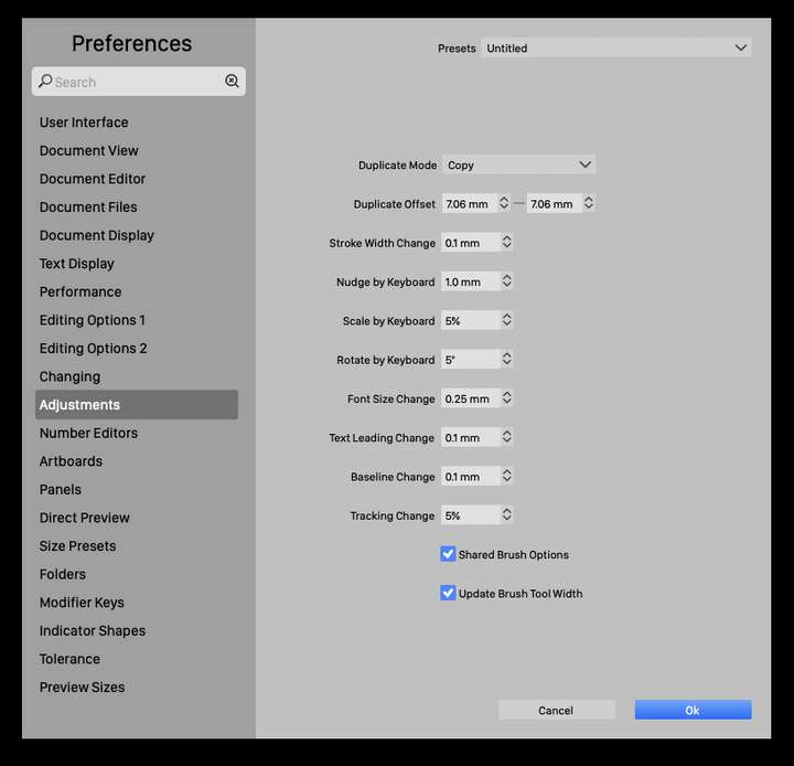

            Mine is working fine, VS1.1.100
            Preferences>Adustments
            You can set it up at

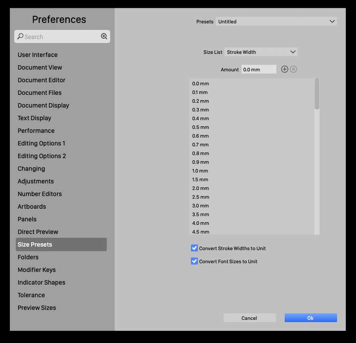

            And,
            Size Presets: Stroke Width,Brush Eidth, Font Size
            have been reset by a clean install?

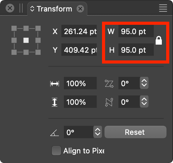

              I use an app cleaner to remove all traces of VS, so yeah, everything starts from scratch. Yes, I have went through the Preferences, but those values that you are showing have nothing to do with the width and height of the object.
              This one I'm talking about:
