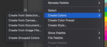

          @VectorStyler I can see the value of an option to "create new color palette" that would then allow for adding colors to that palette using the hamburger menu options that already exist - create from selection, create from canvas, create from document, dragging colors in, etc. The pieces are already in place for that.
          A newly created palette would not replace the default palette of that in-use VS document file but would allow for easy creation of palettes that could then be swapped out with the default or used as the new default in future documents.
          A new palette could come with the reg black and the "none" by default.

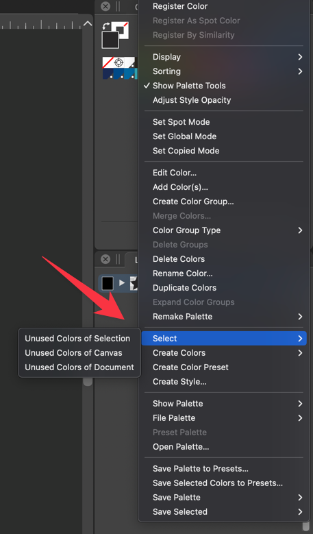

            Boldline @pentool
            @pentool said in Create your own palette:
            but it seems I cannot even SHIFT-select all the default swatches, so I have to delete them one-by-one...? That's somewhat painful...
            I agree it should be easy to shift click all colors between the first chosen color and the last with the mouse.
            There is a current option in the palette hamburger menu to select all applicable colors in the palette at one time based on certain parameters
