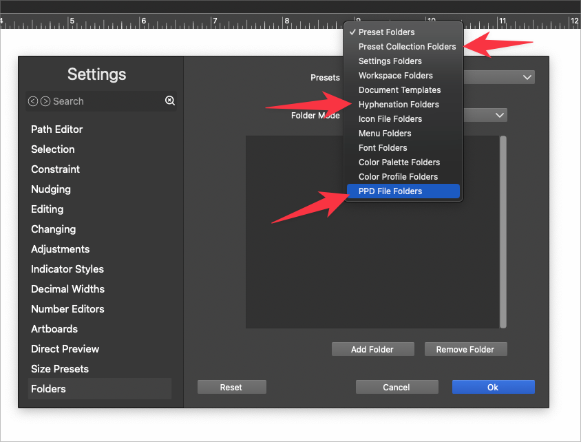

    What are these folder options in the settings>folders>folder mode section?
    2 Posts 2 Posters 3.2k Views 1 Watching
      In the settings folder, there are folder options for "preset collection folders", hyphenation folders" and PPD File Folders. Could someone elaborate on what they are for? I was looking in the references but did not find them. Thanks!
      0_1696866180220_1c27ce37-8af7-46c8-a900-4f8dad63b14e-BLD 2023-10-09 at 11.38.54.png
        @Boldline In order of appearance:
        • Preset Collections these are folders containing *.preset (VS) files, you can add these and presets will be scanned from there.
        • Hyphenation custom hyphenation dictionary files.
        • PPD File - Postscript Printer Definition files for VS Postscript printing (not with the host system driver).
