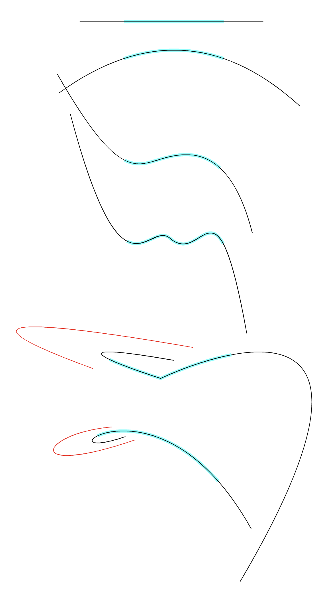

    Quite pleasantly surprised with the Extend path tool
    15 Posts 5 Posters 13.8k Views 4 Watching
      VectorStyler @Ayo
      @Ayo
      Question: what exactly the tool does in terms of curvature.
      The extension mode can be selected in the context panel "Extend Mode" drop down (cut of, have to fix that).
      By default it will extend along where the curve would go, which in case of the cubic segment is just the continuation of the curve outside of the [0,1] interval.
      The Arc mode is the one that uses constant curvature.
      There is still a bit of a sensitivity issue with dragging the endings in arc mode, I have to fix that.
