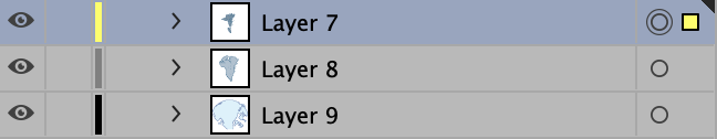

                    Again ; should become much more intuitive. Selecting objects on the artboard and then click or drag (with or without the help of modifiers or extra object/target symbols) on the desired layer. No menu hassle.
                    Freehand did it by selecting the objects and clicking then the name of the desired target layer.
                    AI has the tiny squares (yellow layer color square at the end of the bar) with which you can drag selected object(s), selected on the artboard or the entire contents of a layer selected with the radio button in the layer, to another layer without the need to expand the layers or digging into layers with a thousand objects.
                    Ai screenshot
