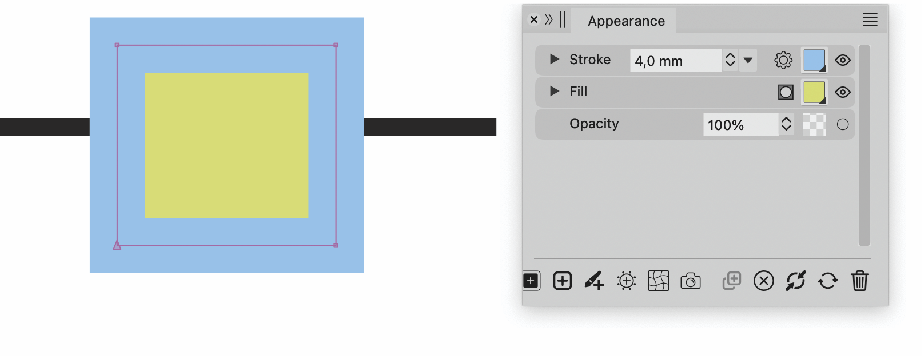

  • How to assign a blend (for instance multiply) to only the fill of on top object or only it's stroke?
  • @Ayo I expand the Fill or Stroke attribute in the Appearance panel,
    click the Opacity button under it and choose a blend mode from
    the menu: https://recordit.co/nWeKClFQDC
    @Ayo Also: open the Transparency panel, highlight the Fill in the Appearance panel and select the Blend Mode in the Transparency panel

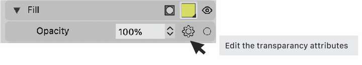

  • @b77 Thanks. Strange place.
    Hovering over the symbol says "Opacity'. Because the opacity can be controlled in the selector to the left of the symbol, it looks more like a miniature that belongs to the opacity selector. No sign, symbol, triangle corner or what so ever to invite to click or search for blending mode (and more).
    Stroke has the setting gear. That's inviting!
    I would understand something like that better with a better tooltip description.
    @Ayo I will update the tooltip. There is no icon here, because it is a preview of the transparency mask.

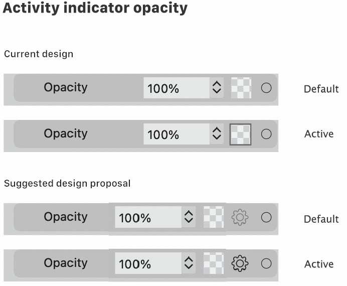

  • @Ayo
    An additional thought...
    Since there is no no opacity setting readout in the appearance panel. Would it be useful to have an indicator that shows that the opacity setting is somewhere other than default or none?
    Masks provide a preview but blend options do not.
    Like so...

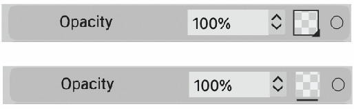

  • @Ayo OK, I know what you mean.
    There's no need for a preview square (non-button) and a separate button for this.
    The opacity button could look like this:
  • @b77 said in How to assign a blend:
    The opacity button is here a preview with button property
  • @Ayo
    Is a separate checkerboard square needed to preview the
    actual opacity value? If that is what you mean.

    I will try to summarize for you in the hope that my point will be clear.
    I started this thread with the question:
    I couldn't find a button for this in the Appearance panel.
    You pointed me to click the Opacity button. That was the solution.
    Hovering the symbol says 'Opacity'. I advised Vectorstyler to make a better tooltip description like 'Edit transparent attributes' or so.
    Vectorstyler pointed out to me that it was no icon but a preview of the transparency mask.
    I told Vectorstyler that being a preview was the cause of my confusion. I saw a preview so I didn't suspect there was a link to transparency attributes. That's why I couldn't find it.
    I then recommended Vectorstyler to make it clear that it is also a link for careless users like me. Or instead an extra setting icon (like a gear or something). Then you have a preview and separately a settings button.
    That's 1
    Yesterday I stubbled across the fact that I couldn't see whether or not I had applied a blend/transparency effect to an object. Illustrator gives me an opacity-blend readout in the Appearance panel. But vector styler gives no feedback. You have to dig into the settings to check.
    Therefore my final suggestion for an activity indicator based on the existing opacity bar and based on the bar I proposed with an extra setting icon.
    That's 2

  • @Ayo Thanks!
    Well then… isn't it better to have two dropdown menus here?
  • @b77
    Very clear and beautiful!
    but there are more groups than Blend Mode on the menu
