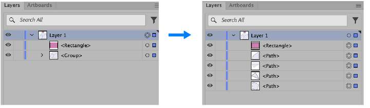

Why do I lose my fucking layer when I want to ungroup all groups in that layer?
See video: https://recordit.co/20NymTGCMG
Now I foresee you saying select the group in the layer and ungroup it. That works, but I work with long long lists of mixed objects and groups.
Illustrator gives me the logical result: skip the object and ungroup the group. Keep the layer.
Keep the layer.

I almost have found a workaroundDon't like workarounds but I almost have found a workaround to batch ungroup all groups within a layer while preserving the layer.
Almost because it seems that only the listed visible items within the panel are converted. Items outside the panel remain {group}.WHAT IS THIS?

@Ayo It should select all (not just visible). I have to replicate this.
