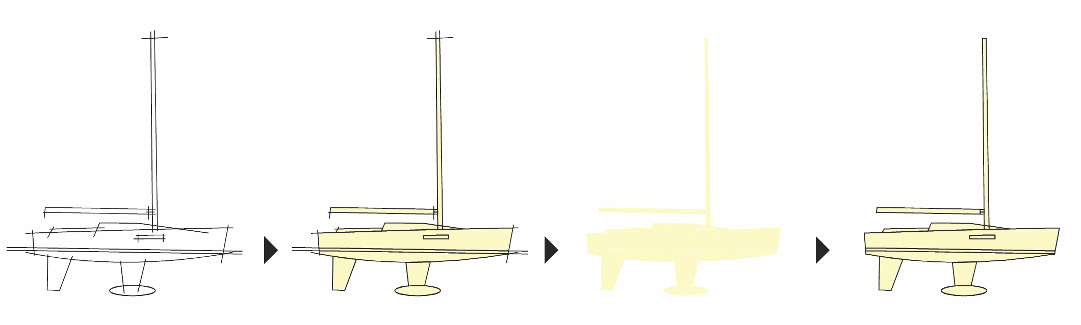

Yes.Shortest route goes like this (AI):
- Create line drawing with all strokes uniform style
- Group
- Live Paint > Make
- Set fill to a color, stroke none
- Live Paint > Expand
- Ungroup
Ready.
The approach as a whole is especially useful if:
- line drawings become more complex. Take an .ai export perspective drawing from e.g. Moi3D. Can be very complex and there are always small parts/slivers that you overlook with manual tapping shapes.
- you want to slowly build up your drawing in phases.
