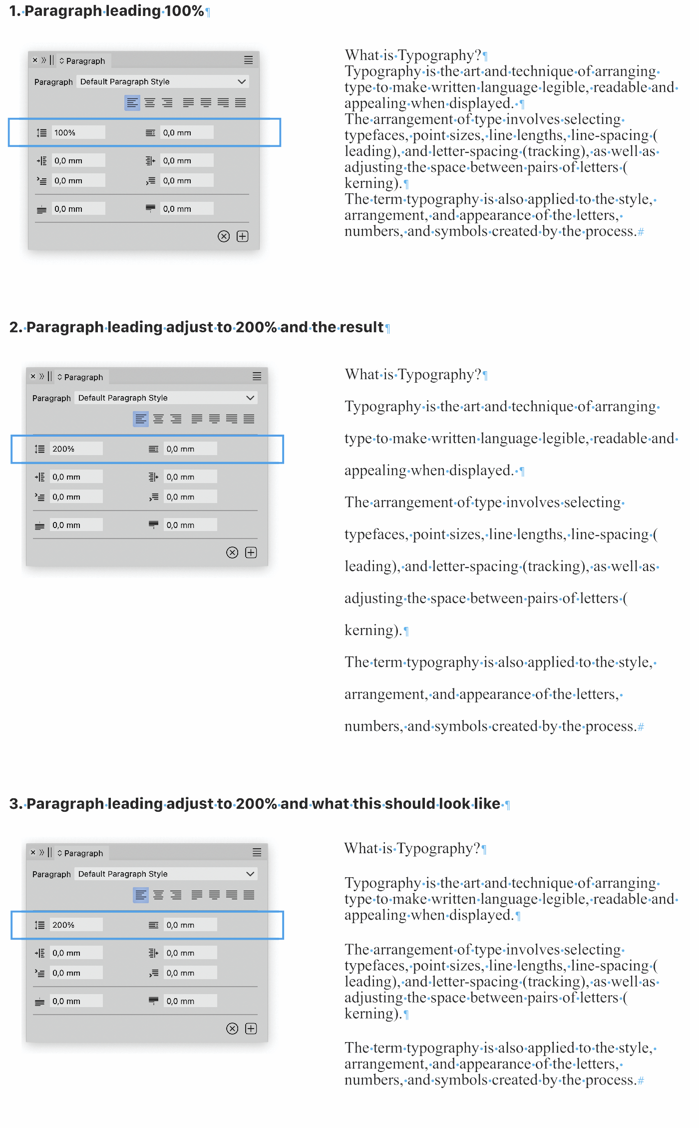

Typography 1: Paragraph Leading

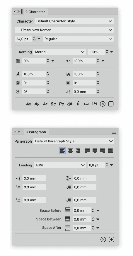

@Ayo Shouldn't this (3) be the before / after space (last row in the panel)?
Leading shouldn't be there at all.
Interferes with character leading in character style panel.
There it is covered and in the right place. Can go! Like so...
Or vice-versa like so... (QuarkXpress approach, more logical in my opinion)
@Ayo I will have to think about this (after the next build) on how to reconcile the leading issues.
The problem is that character leading "override" might be needed for some fonts. -
