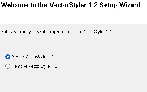

      Every time you open the beta, VS announces an update and after downloading proposes a repair... and it goes on and on!
        VectorStyler @B-Vs-V
        @Pat Fixed!
        • encartE Offline
          encart
          In my case, the latest build did not solve the problem. The installation seems to have gone fine, but on startup, build .002 appears on splashscreen. Every next attepmpt end up with the window that @Pat sent above.

                @encart said in New release - doesn't install:
                @Vector Didn't solve the problem. Same situation as it was
                I have the same problem - I cannot install the 004 version by downloading or automatically.

                    Harry @VectorStyler
                    @VectorStyler I managed to solve this issue. I installed a new version (004) using the repair function of the installer.
                    Installer created a new instance of VS with a new shortcut called "VectorStyler 1.2".
                    I was using the old shortcut in the task bar, which was triggering the old (002) version, because I had two versions of VS in the Add/Remove Programs List of the Windows control panel (VectorStyler and VectorStyler 1.2). It looks like something is wrong with the installer.
                    After uninstalling the 002 release, a new one seems to work fine.
                    • B Offline
                      B-Vs-V
                      Yes indeed, I had also allowed the "repair" of VectorStyler the first time not knowing what to do, and the complete installation succeeded after the fix of the beta version.
