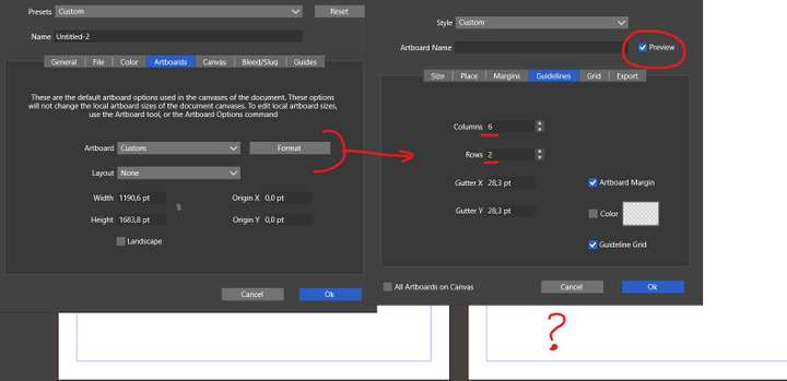

I don't think I'm making a mistake, but maybe I'm wrong in thinking I'm not

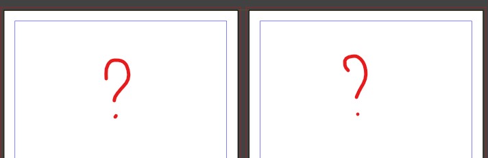

I try to create guides from the artboard margins... nothing happens.
@Pat Replicated here also, does not work for new document. Works from the Canvas -> Artboard Options.
Will be fixed ASAP.

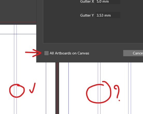

@VectorStyler I have a document with 2 artboards.
I want to design guidelines on one of them but I get the same guidelines on both:

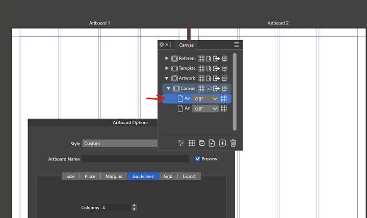

@Pat Are the arboards all fully inside the view?
Try selecting the artboard first with page up/down, and then go to the artboard options.
@VectorStyler Here another view, with the canvas & artboard panel:
@Pat said in Document setup & Guidelines:
I will try to replicate this issue. It could be related to the recent (last build) changes on how the artboard options are edited.
