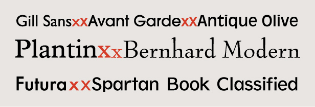

@VectorStyler X-heights can vary a lot from typeface to typeface:
Because of European Union's regulations for packaging, it would be very
useful to be able to specify the font size based on the x-height value.According to EU’s FIC Regulation 1169/2011, a minimum font size
applies to mandatory information (ingredients for instance) which you
must print using a font with a minimum x-height of 1.2mm.If the largest surface area of packaging or label is less than 80 cm squared,
you can use a minimum x-height of 0.9mm.Same rules continue in the UK after Brexit.
