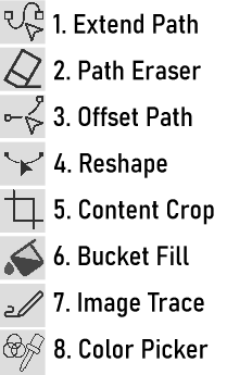

      Hi, I am very excited to see some new tools in version 1.2.007 Beta of Vector Styler. It seems like there are eight of them; correct me if I missed one:
      Below is the name of each tool and the tooltip explanation. following that is my discoveries and questions. I would love to hear what you have found using the new tools.
      1. Extend Path - "Extend or reduce open paths along their curvature".
        This tool is brilliant! It reminds me of a similar tool in FontLab. For all you node control freaks, it allows you to slide a node along a path and VS will do its best to retain the original curvature. As well, if the path is open, you can slide the first or last node in the direction on the path and it will extrapolate the curve. Thanks for this powerful tool.
      2. Path Eraser - "Remove section of a path".
        It seems like this has two modes: If you draw the eraser along a path segment in the direction of the end point, it will erase that section of the path. It you draw the eraser towards the start point, it will break the curve at the start and end of the erase mark, keeping the two paths overlapped in this erased area. Is this how the tool is supposed to work?
      3. Offset Path - "Create destructive local path offsets using variable width profiles".
        Seems like this will allow you to use the concept of the variable width profile to drag a line segment between two nodes, perpendicular to itself. You can slide the drag new controllers along the segment for more control. This could be very handy to create a manual offset. Nice!
      4. Reshape - "Move and stretch the section of a selected path".
        This one is a bit hard to figure out. It seems like it can only be used on nodes, not paths, and it differs from the Node Tool in that it will break the handles of the adjacent nodes to perform the stretching. The ESC Key is the only way to release/execute the Reshape. Please correct me with a more accurate definition, as I cannot fully grasp what this tool is doing and how to use it effectively.
      5. Content Crop - "Adjust the frame of a content object (image, or vector) to crop the content".
        A long awaited tool for me, allowing the easy cropping of placed (imported) images. Thank you for adding this one as it will save a great deal of time.
      6. Bucket Fill - "Create new shapes by filling regions between existing shapes".
        This one is a not entirely intuitive to figure out how to use. It seems like you have to first select all the shapes, then invoke the tool. A simple click on one of the overlapping shapes will perform what seems like a Union Boolean (combine shapes - Union), leaving the original shapes as under-layers. This could be a potential time-saver. Clicking on gaps between shapes seems to fill them.
      7. Image Trace - "Create curves along edges of an image. Use Trace Guide panel to setup images for manual tracing".
        I am having some difficulty figuring out how this tool works. I tried to set up the trace in the Trace Guide Panel, but I did not achieve any satisfying results with a high contrast image (like one of the above icons). I don't have a lot of experience using VS's tracing, so please let me know how to use this new tool.
      8. Color Picker - "Pick colors from pixels of the document and apply on objects".
        Seems simple enough, but it does not work for me. Perhaps it is not implemented in v.1.2.007 Beta?
      Again, I would love to hear your findings with these new tools or any answers you may have. Happy explorations!
      VectorStylerV BoldlineB 2 Replies Last reply Reply Quote 4
        VectorStyler @Victor Vector
        @Victor-Vector said in The 8 Exciting New Tools:
        I think the second part might be a bug. I will try to fix this for the next build.
        Select two or more nodes with the Shift+ key. Then drag the segments between the selected nodes.
        There is a bug with this tool. The cursor is offset from the actual fill location. Otherwise it should work for both selected only, or all shapes on the canvas.
        Use the Trace Guide panel, select the image and click on the 3rd button to set a default edge detector and show the image in edge mode. The use the Edge Trace tool (second form last in the panel) and click on the edges in the image.
        Adjust options based on what the image needs.
        This was there before, if form of a Shift+ modifier in the Style picker tool. Seems to have some problems with activating the tool, will be fixed.
        Victor VectorV 1 Reply Last reply Reply Quote 3
