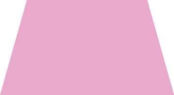

      What steps do you take when drawing a trapezoid?
      Please let me know how to do it in as few steps as possible.
      In the future, I would like to have a trapezoid tool.
      It should be in Transform.
      I would like to develop it further and have an effect to give perspective to the object.

        I draw a rectangle,
        then I convert it to curve (right click),
        then I select the 2 nodes on the top,
        then I use the scale tool (or change the width value in the transform panel if I need a specific size).
        I agree that a trapezoid tool or readymade shape would be nice.

          here also a description from me 🙂
          Freehand:
          create a rectangle
          convert it to curve
          select the two upper nodes
          switch to transform Tool
          hold ctrl (win) while move the Nodes
          With the Transform Panel:
          create a rectangle
          convert it to curve
          change the Value in the width Field
          ( with Up and Down Keys
          or with the Mouse - Scrollwheel
          or just typing )

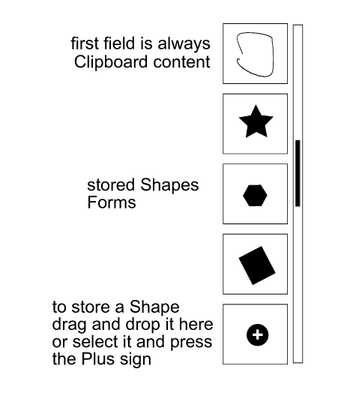

                  Subpath @VectorStyler
                  @VectorStyler said in trapezoid:
                  @Subpath said in trapezoid:
                  I'm missing more of a Shape Library Panel
                  You can create shape presets with the Presets panel. Then select those shapes to replace some shape in the canvas.
                  (I will also add drag&drop creation).
                  remember that, but be able to use drag and drop
                  would be a little more fluid
                  the idea it self came from the app "Concepts"
                  on my iPad, here a sketch how it works in Concepts
                  just for inspiration
                    Boldline @Subpath
                    @Subpath The solution "concepts" uses seems like a very effective solution. What do you do if you have many more unique shapes? There seems to be a limit to what can be shown in that layout example you shared
                      Subpath @Boldline
                      @Boldline said in trapezoid:
                      The maximum of that storage fields visible on the screen are 12, on my iPad Pro 12.9.
                      The maximum number of shapes is higher because you can switch between different libraries.
                      For architecture, electronics, shoes, faces, etc.
                      Since scrolling on the iPad is fast and smooth, scrolling back and forth isn't
                      much of a problem
                      Saving a shape only takes one click,
                      also just one click to place a shape on the canvas (or drag & drop).
                      So using this shape storage is also pretty fluid.
