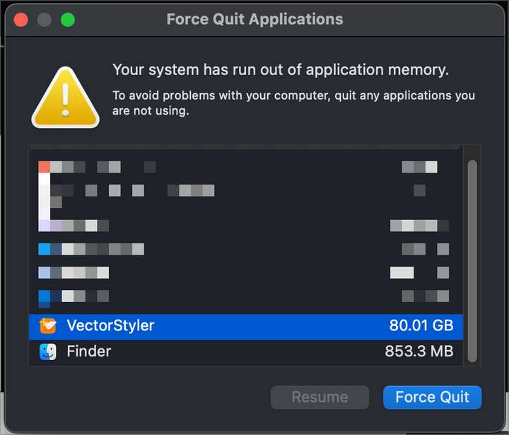

      Hi, ran into this repeatable problem.
      1. Using line tool draw a line
      2. Apply a scatter brush (screenshot below)
      3. Using stroke width tool change width. The first change works ok. Adding another node causes program to freeze.
      4. Close VectorStyler using Force Quit (see screenshot showing system memory).
      [Not related but the straight line tooltip shortcut shows two backslashes.]

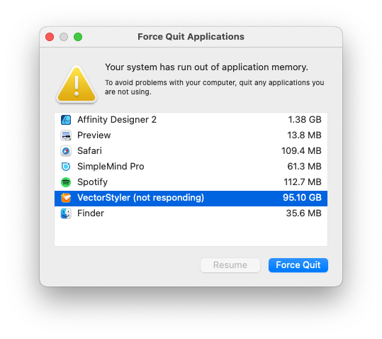

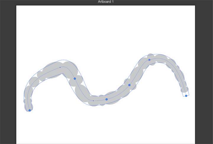

            @VectorStyler @Jono
            I was able to replicate the same issue but it took adding more nodes and trying to use the stroke width tool further before it eventually froze on me
            Here is a video where it froze while using the path width tool
            Here is the file I recovered after force quitting:
            0_1705507425736_width tool freeze.vstyler
            The variable width support for scatter brush new feature seems awesome when it works! I hope the bug gets resolved because I could make good use of that new ability.
            0_1705506894417_04d0ccaf-4050-4f91-8ea8-5faf279e19a3-BLD 2024-01-17 at 10.53.19.png
            0_1705506994658_d9a6afb9-2e4f-4806-a09a-e7237de39a31-BLD 2024-01-17 at 10.55.57@2x.png
              @Boldline Got it. It can be replicated here also.

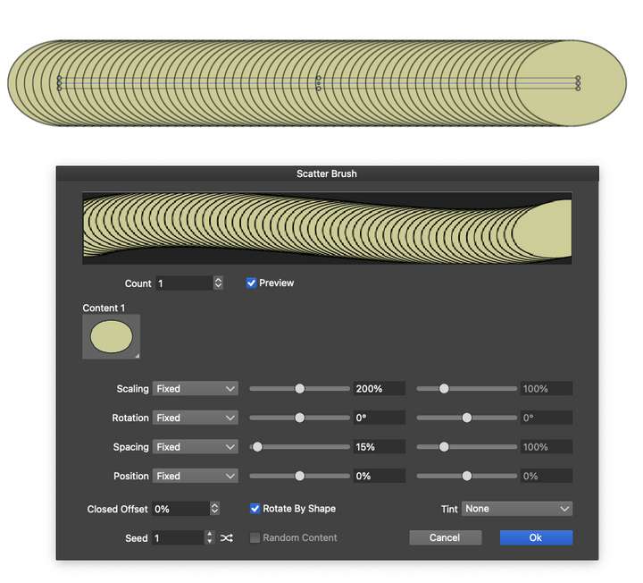

                File attached in case you need another example, and a screenshot of the settings I was using. (increased scaling and decreased spacing)
