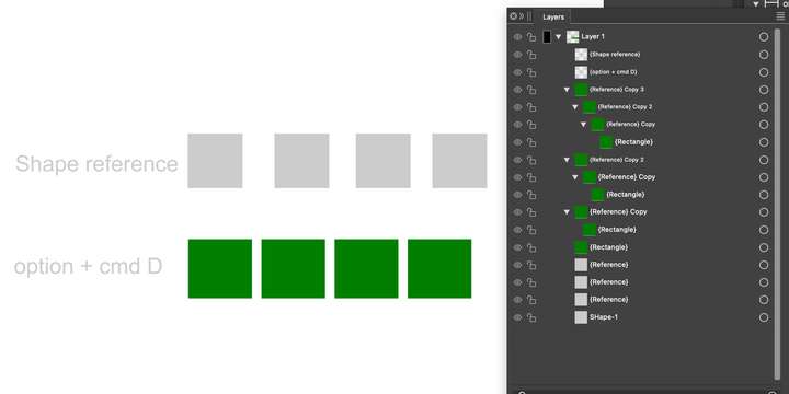

Just curious about reference function and how it works.
If I use reference shortcut key child objects are nested as you see in layers panel (In reverse order) and they are labelled as "copy". Not the case if I use name/role method.
A reference is a "reuse" of an object (or a symbol). Unlike a clone where styles can be changed, a reference remains an exact copy of the referenced object.

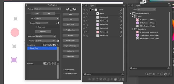

Currently, if I select an object, all the referenced styles to that selected object are highlighted in the styles panel.
Is there a way to highlight all the objects in the canvas/ layers panel where all selected "reference role or roles" are applied? Perhaps it's already there and I couldn't figure it out.
Thanks

@Kumr said in Clone (Option+D) issues:
This would be something like searching for objects using some style.
I think this should be doable with the Find/Replace feature: press the "More" button to enable more features and setup a condition ([+]).
But depends what the style (or reference) was used for.
@VectorStyler I am not sure if I am doing it right. Here is the screenshot of the search panel. Search for objects first then the role. I get a message nothing found.

@Kumr Send me that file. It is not clear what you want to search for. Is it the original reference objects? Or is it the objects that are using those styles?
@VectorStyler Sent the file by email
@Kumr Got the file. The problem is that the find / replace does not list used styles if they are from references. This is a bug / missing feature and will be fixed in the next build.
