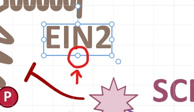

I'm having a difficulty automatically adjusting the size of the frame to the text. In Affinity apps, it's really very simple: just double-click on one of the "control" points of the text block (horizontal or vertical) and the frame is immediately adjusted to the content

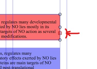

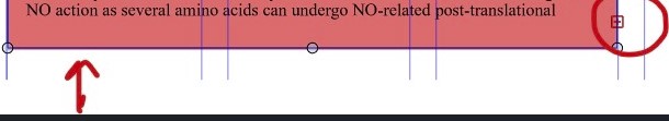

@VectorStyler A small glitch: after adjusting the frame to the text, the (+) sign seems to indicate that part of the text is hidden when it shouldn't be.

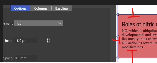

@VectorStyler I've retested the paragraph styles and there's no problem with the ones I've set up, everything seems fine except for the 'Fit frame to text' option.
I added an identical inset for all sides and the frame didn't fit
so I applied the 'fit frame' option. The first time, VS crashed (crash report sent) and then the frame didn't fit properly.
@Pat said in Adjusting a text frame to fit the text:
I will try to replicate this.
I cannot replicate this issue with the latest build.
If there is an example file (at list for the fit frame part), please send it to me. Thanks! -
