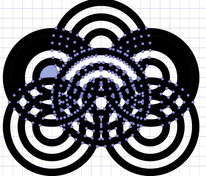

Hello,
I have the following object
When I delete the blue small object in the middle the circle on both side get inside black
here the whole picture,.
Here the attached file.
0_1707885992567_circle_test.vstylerI had several tries with other object, the shape builder tool has quite sever issues and not working very well overall. I had the feeling that 6 months ago it had less problems,when I did use it the last time.

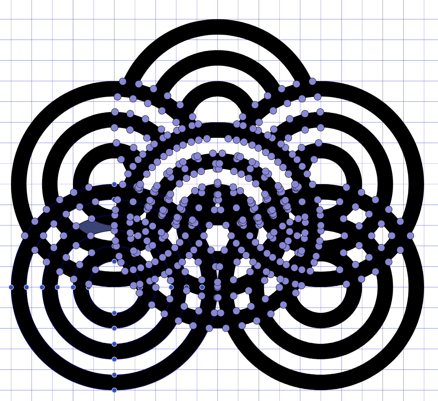

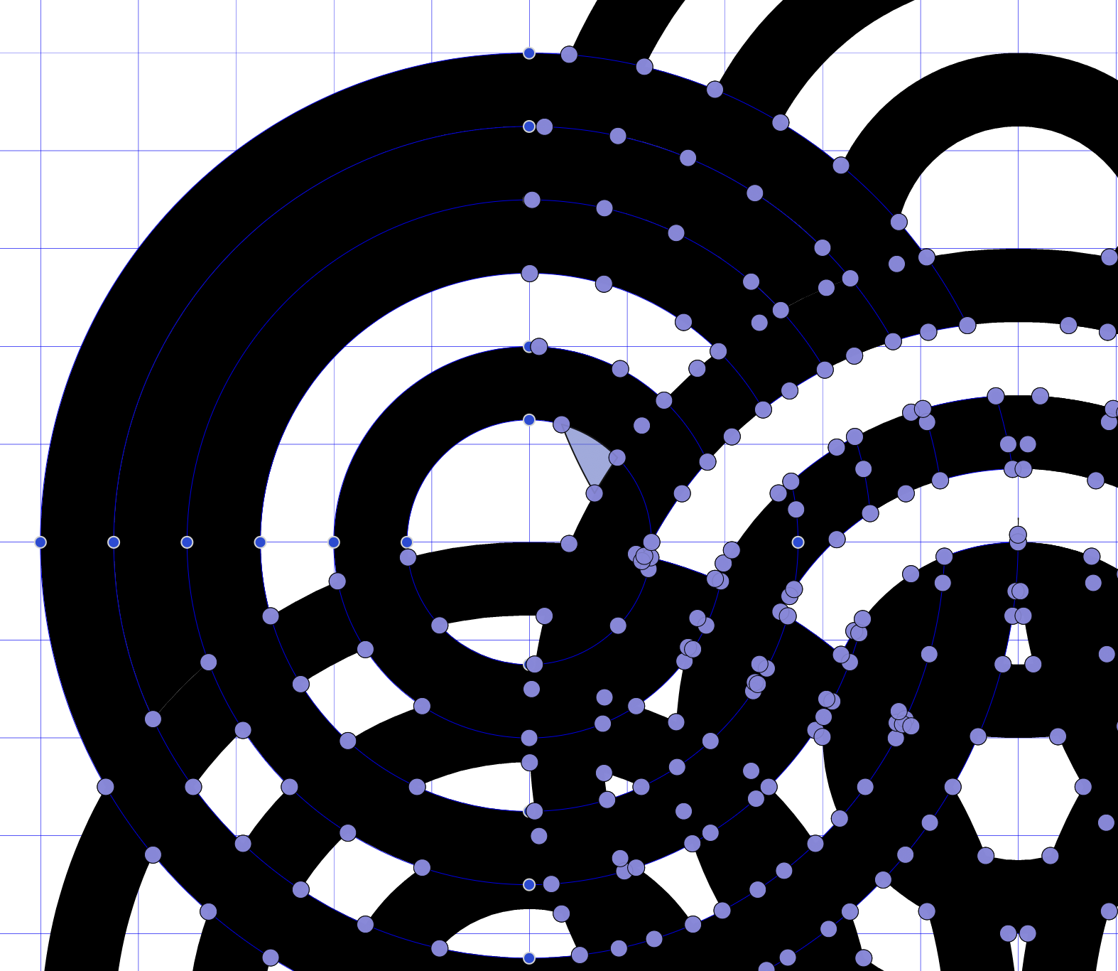

Please have a look at this video.
At the end you can see that the things are going wrong again.https://recordit.co/ySjUsgIPJ3
Here the file from the video.
0_1707989772111_1707885993349-circle_test.vstyler
@MajorTom Restarting the shape builder with the additional rectangle at 2:53 might cause the problems. I will try to replicate this.
@MajorTom A workaround for now: from what I can see, the goal is to clip / cut the shapes into the rectangle.
This can be done by placing those objects into the rectangle (drag&drop in layers panel) and then Expand Clipped Groups.
