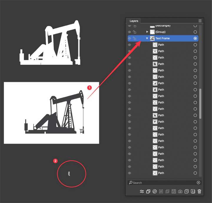

      I have a shape that was somehow accidentally converted into a text frame. I saw numbers inside the shape and tried to remove them and when checking the layers panel, saw it was titled "text frame" (I assumed it would be a text shape?)
      I've tried going in with the Deep Selector (before I realized it was a text frame) and that crashed VS
      Then I went back in with some options in the "Text" dropdown menu to no effect before using break-apart. The break-apart managed to drop all the type out, but left them linked and the object in the layers menu is still titled the same, "text frame"
      0_1710452913340_5bbb5961-a01f-458f-95fe-b6c8d6e31c5b-BLD 2024-03-14 at 17.46.11.png
        @Boldline In the Appearance panel, select the Text Frame item and delete it with the Appearance panel delete button.
        In VS an object with a shape can contain various content types, these are Fill, Stroke, Adjustment Effects, but also Image content or Text Frame. These can be added to any object with a shape, even after it is created (example: flow some text in an existing shape).
